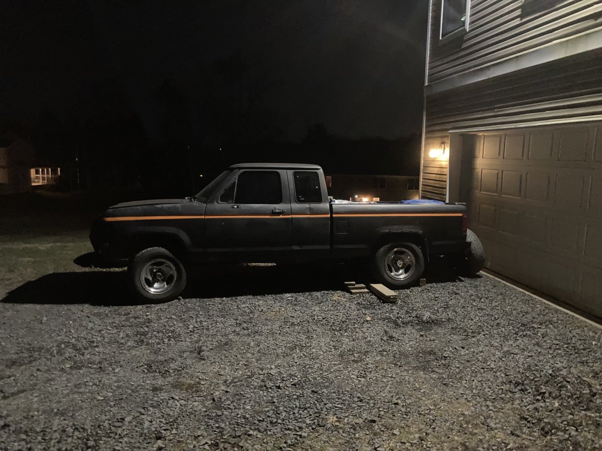

The boys got inside the truck yesterday and started work, cleaning up the interior. They're happily surprised about the condition, only a nickel-sized rust hole and a shotgun pellet hole in the roof to weld up so far, everything else seems solid and workable. We'll need a few interior trim pieces for the passenger door A pillar, as well as 2 door-panels, but looks decent so far. As soon as I put my new 235/65r17 Hankook AT2s on the Highlander's stock wheels, the 235/70R16's Ecopaths will go on the truck as well. We have 5 of the Explorer style 3 spoke chrome wheels, so Anyone in Eastern PA/Western Jersey need 15" Ranger steelies? 1 is an 88 era, 3 are second/third gen wheel style....
Started improving the looks- 235/70r16 AT’s on it- thinking it will need fresher springs for a proper ‘lift’ from this ride height.

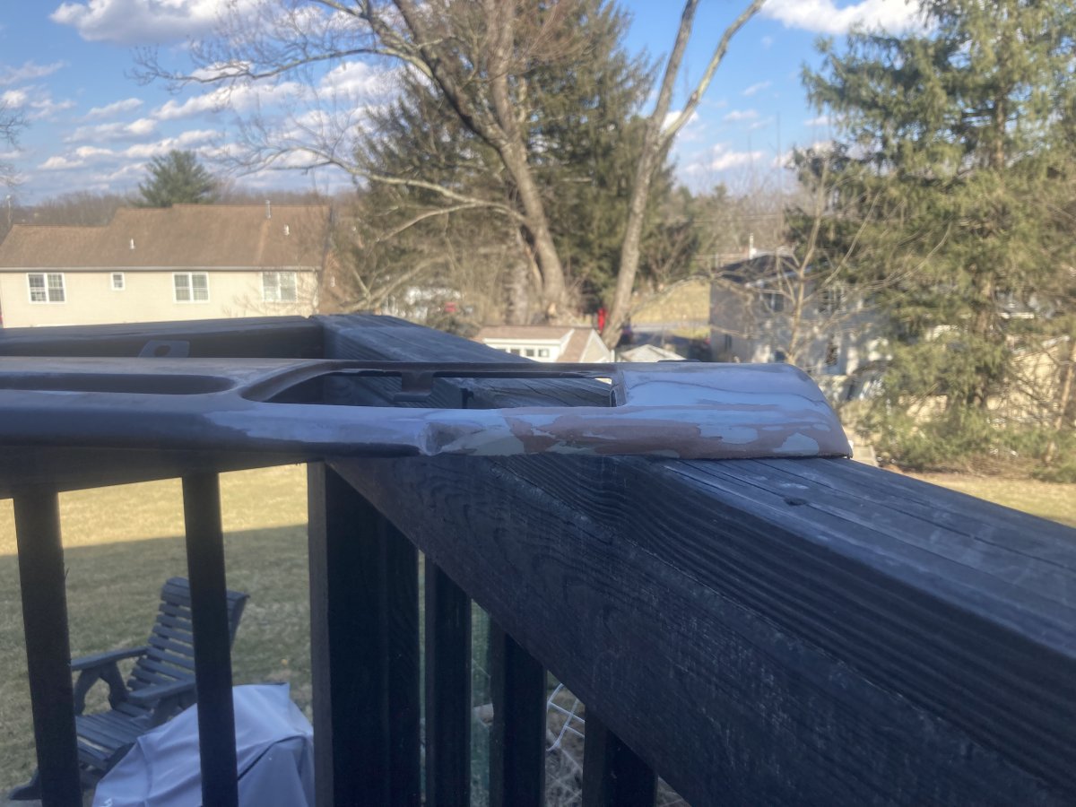

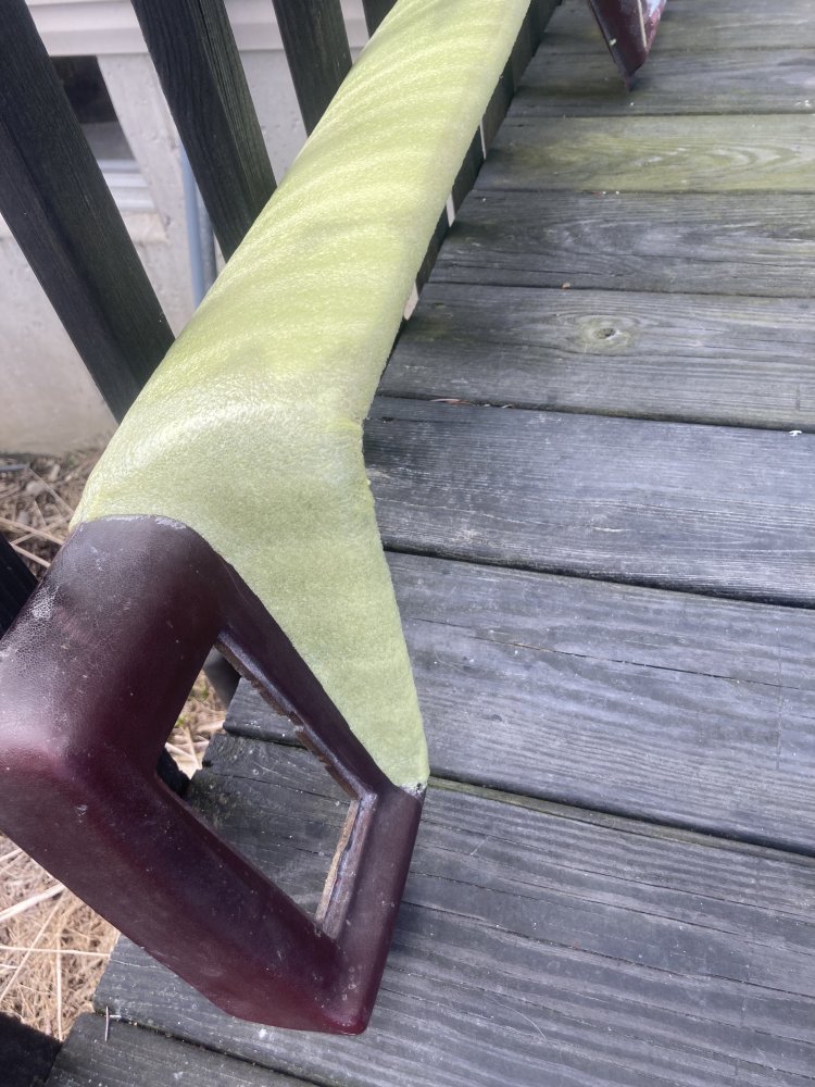

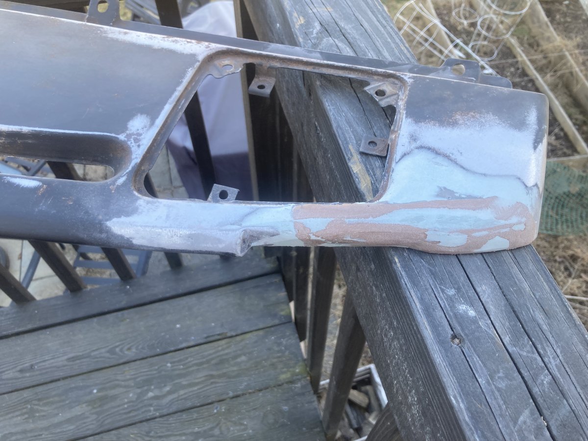

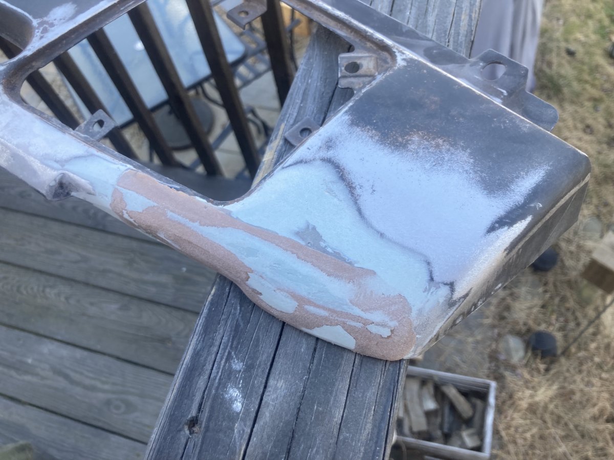

Did work on the dash pad (2B Black synthetic Leather wrapped), the front dash panel (2B Grey synthetic Leather wrapped) and the metal dash itself:
See pics:
I'll Update Pics- They failed the format they're in from my iPhone to my Google Drive- I'll figure it out shortly- Sorry
Here we go!-

I straightened the left front tweak on the (about 90% better) the factory front bumper he will use temporarily.
