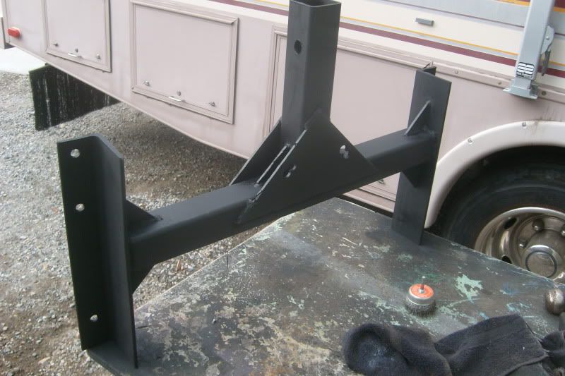

I think since you need safety chain hook ups, get some 1/4" plate, cut it in a triangle about the size of the receiver length, then weld that on there. It would give it considerable amount of strength.
Looks great other wise! Keep up the good work!
That's exactly what I'm going to do. There is going to be a triangle on both top and bottom of the receiver section, overlapping on both the receiver section and the main cross tube. Then, on the bottom triangle is where the safety chain holes are going to be (I'm just going to cut holes out right in the triangle itself).
I'll be sure to add some more pictures when I'm finished!
yeah the problem with your gussets in the middle of the tube i that they don't line up with the stress, so they will just cause cracking rather than add strenght. i know i'm just dumb kid but don't worry, i learned it from a smart old guy
Yeah I agree. Those gussets are to help with side to side movement. I'm going to be making some other gussets that will go on the other sides of the receiver section to help with the downward stress that the weight of the trailer will create.
Alright, pretty much finished. I just need to get the truck wired for the trailer and probably fix my safety chain holes since I screwed them up.
