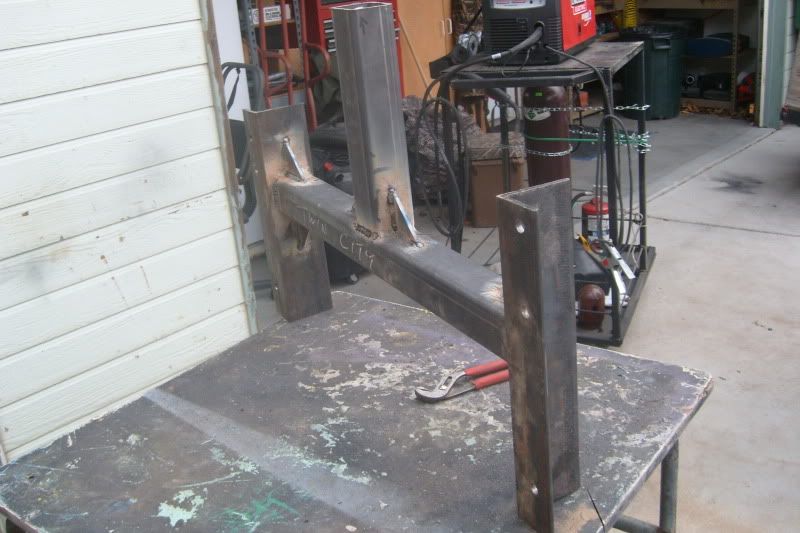

Well, I got a free trailer from my grandpa. He had it sitting behind his little shop in his backyard. It's about 4' X 6' in size. This will be used to haul my hunting crap...so now I need a hitch for the Ranger so I can pull it. Here's what I got so far. I'm using my Lincoln Electric Pro-MIG 140, flux-cored for better penetration. Not pretty welds, but effective.
It's made of:
2.5" X 3.5" X 0.25" angle iron (where it attaches to the frame)
2.5" X 2.5" X 0.25" square tubing
Plenty of gussets
I've got a little more gusseting to do, as well as drilling a whole for a hitch pin.
You had me until you added the receiver section. You need some additional gussteing or something to help prevent that thing from tearing off from the main cross tube. I would have figured you were going to weld the receiver directly underneath the crosstube with some gussets/safety chain loops.
Looks like a good start otherwise. :icon_thumby:
I think since you need safety chain hook ups, get some 1/4" plate, cut it in a triangle about the size of the receiver length, then weld that on there. It would give it considerable amount of strength.
Looks great other wise! Keep up the good work!
