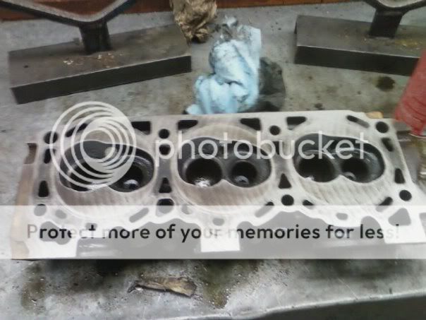

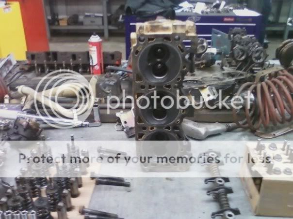

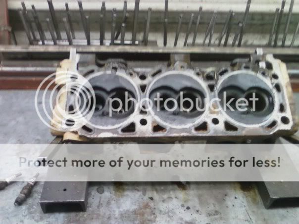

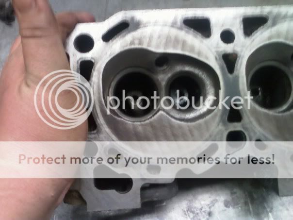

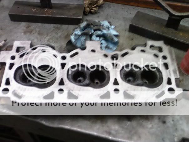

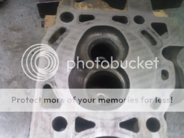

so my progress so far , well this week i disassembled the engine as the pics show. well we checked all the TSB's for the 4.0 on Pro-Sis , and so far i have had no problems (knock on wood ) though i did break 6 exhaust manifold bolts off , for having 261k miles this think shows very little wear. The passanger side head has an exhaust valve seat that is somewhat damaged , we are not sure if it is a bad guide or just a woen spring , checking that monday. We magnafluxed the heads today and they both checked out fine , the block will be ready monday , at which point i am going to sandblast it and prep for paint. The engine will need new rocker arms , but wit the miles and the knowledge of 4.0 rocker arm wear i am not surprised. i will update this more as i do more work. I am ordering a 4.0 SOHC pan for it , and i have to get a 96TF manifold for a Ranger.
driver side head progression
passenger head progression

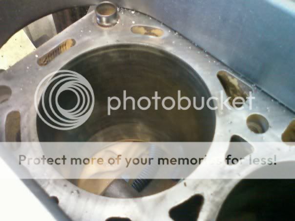

well got the engine out of the bake oven today , pressure washed it , then blew it off , cleaned out the cylinders , found .006" skirt clearance when there is supposed to be .002" at max , so she is getting bored .020" over to have the correct clearance with new pistons
well i checked the heads today , about .002" warpage on both , max allowable is .006" , so i am gonna run them as is , they went in the bake oven today , so i just have to get a list of needed parts and then i will be ready to bore it out and begin reassembly , just need to find a ranger fuel rail
well yesterday i measured valve guide clearance and it wasnt good , but we are gonna tru to salvage the heads , we dont have the correct reamers for my heads so the teacher ordered them.

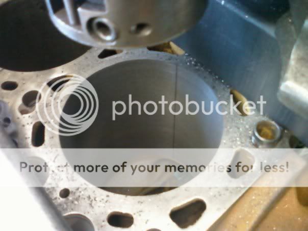

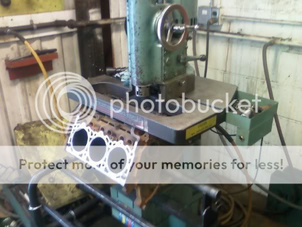

i started to bore my block today , got the first cylinder , gonna continue tomorrow , posting some new pics here in a few minutes , looking for input on my progress.

and it is scary as all hell boring one of these over , because the main bearing web is right at the bottom of the cylinder because of the way they are off set , so you have to have your hand on the engagement lever to be ready to stop it as soon as it is done cutting , because you only have maybe half an inch of clearance before you hit the main bearing web

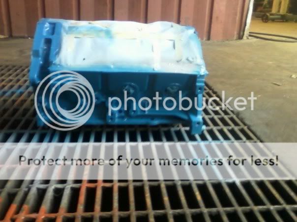

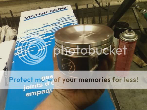

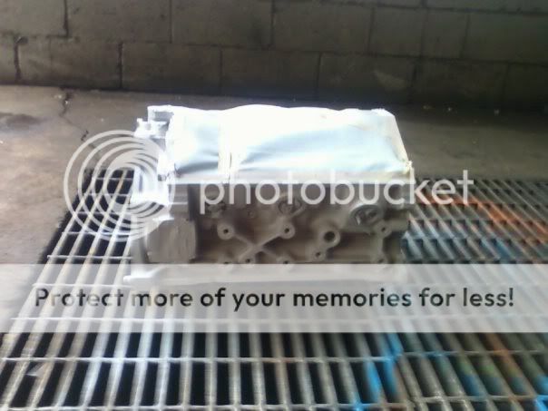

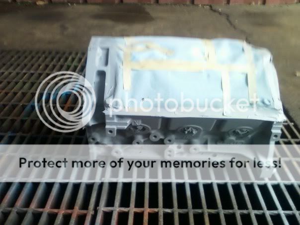

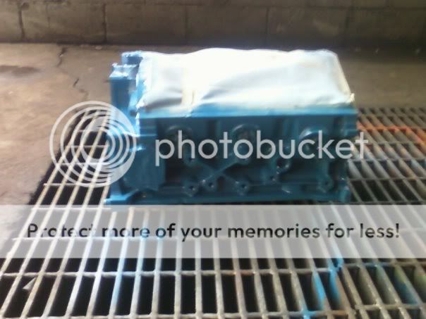

well there are 4 new pics in the first post , i painted the block this afternoon , i will get a couple pics tomorrow when it is completely dry , and i have all the masking stuff off. still have yet to hone the cylinders , i have to get my pistons first , i am ordering my engine kit tomorrow , its everything i need since i designed the kit myself , the bad part it is $1,150.00 , o well , parts are the most expensive part of building one of these engines , as they are not that popular of an engine , i will post my progress as i get further along
after 2 coats of primer
after 3 coats of Old Ford Blue

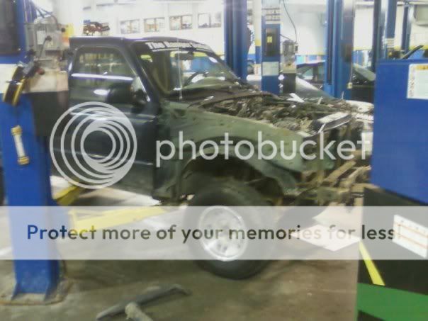

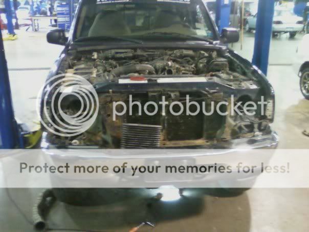

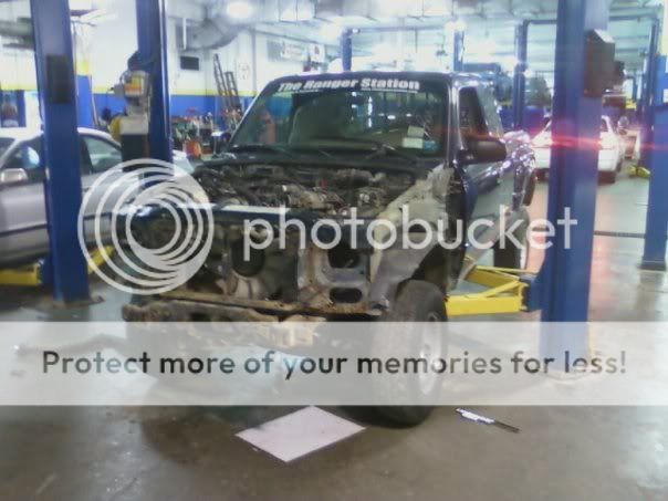

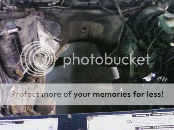

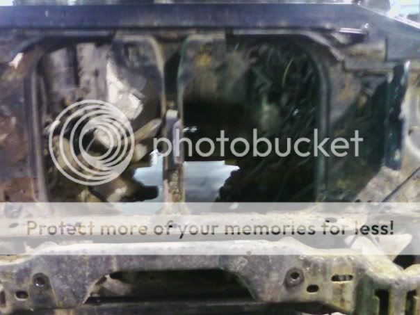

3 new ones up , started to take the core support out , there is one spot i can put my foot through on the thing
the reamers for my valve guides came in today , hopefully getting the power steering lines disconnected tomorrow , then pulling the engine

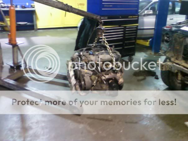

got the old 3.Slo out today , and just have a couple bolts and spotwelds left in the core support , the engine kit should be here either tomorrow or monday , cant wait.

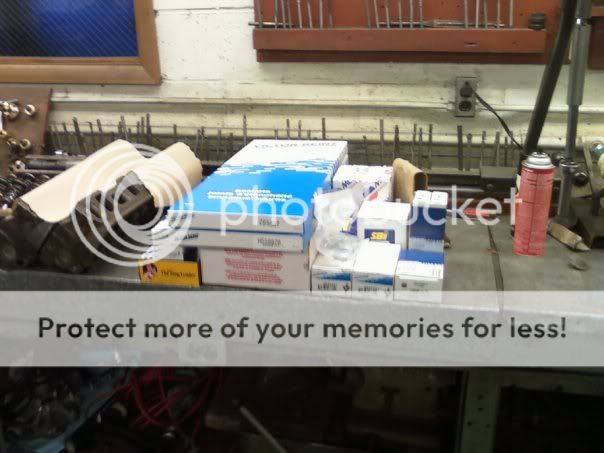

well i was working on taking the core support out on friday when the pars guy came over and told me there was a big box in the engine room for me , my kit came in , it is all name brand stuff.

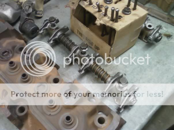

i got a little work done to my engine , just got the new rockers on , a company called SBI makes an upgraded rocker for the 4.0 , they are definantly beefier than the originals.

whole kit
sealed power .030 over matched piston set
rocker shafts with the new , upgraded SBI rocker Arms
