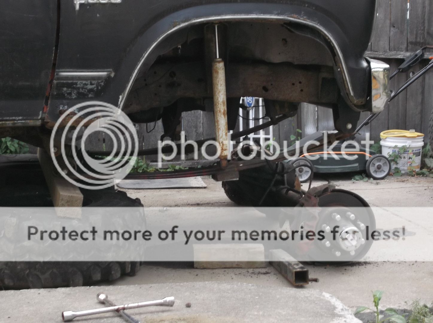

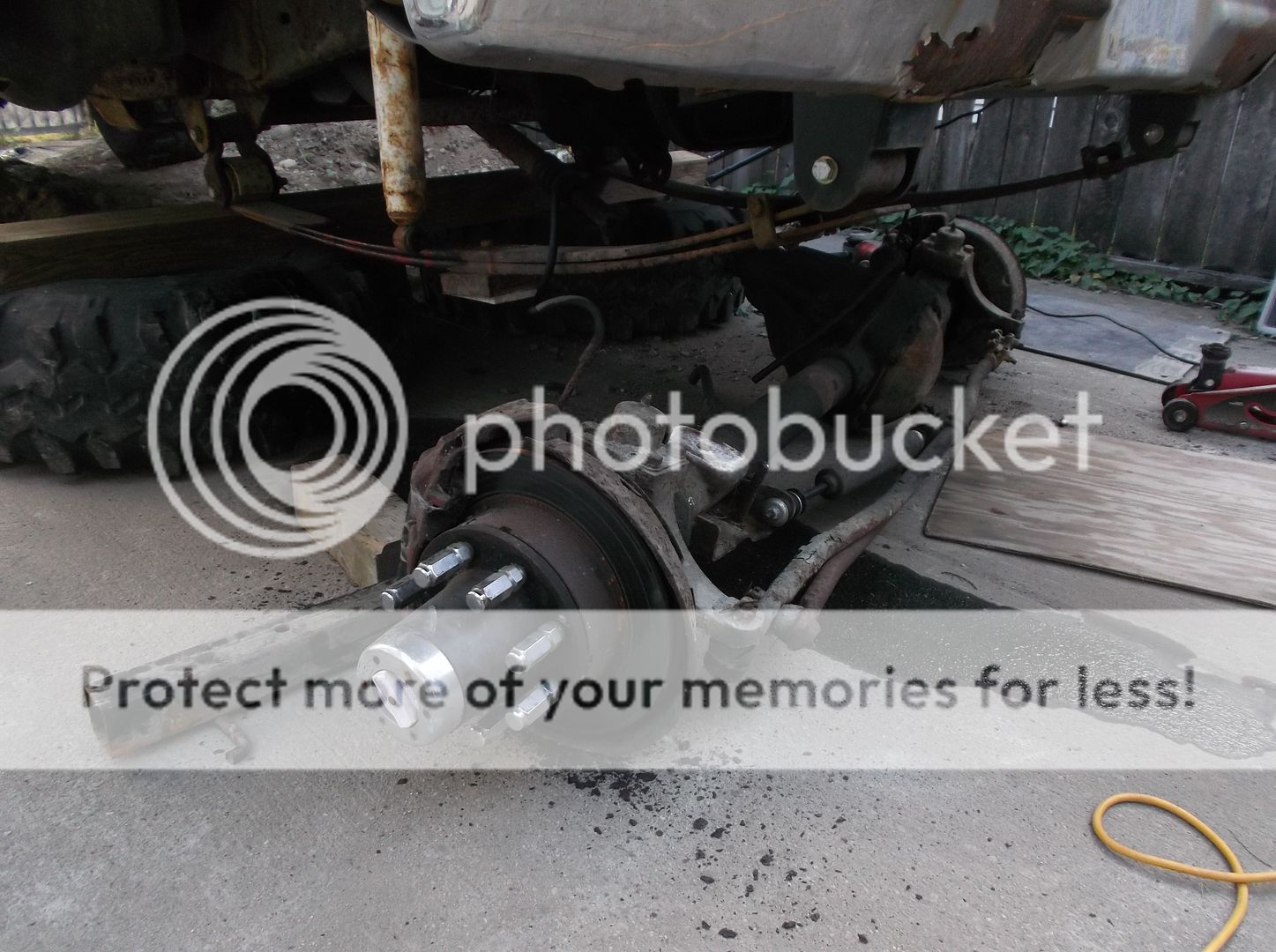

Well today was finally "toast out the F350 day." In the end, all I'm keeping are the front D60, wheels (tires are pretty dryrotted) and some odds and ends.
I'm just out of time and patience with this whole bylaw ordeal. I get a new reminder how many days I have left about every day from the gf. Its kind of unpleasant now since time is really running out.

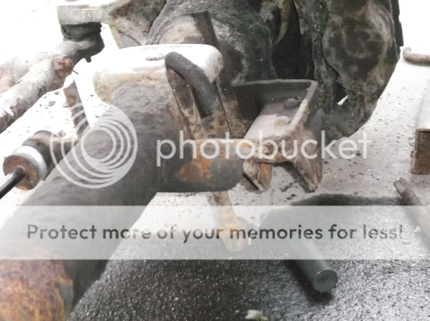

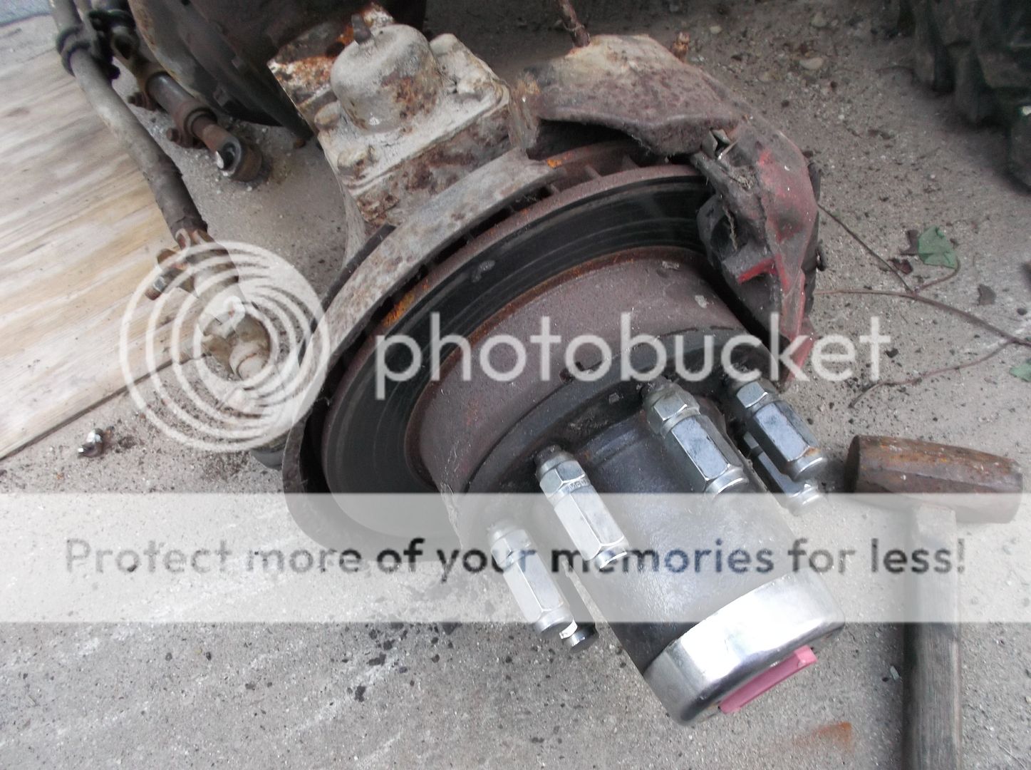

Does anybody have any idea why this D60 equipped F350 would have one TTB bracket in it?
I'm finally impressed with my front axle choice. This thing is a monster.
Is the bracket for a track bar?
Sent from my SM-G920V using Tapatalk

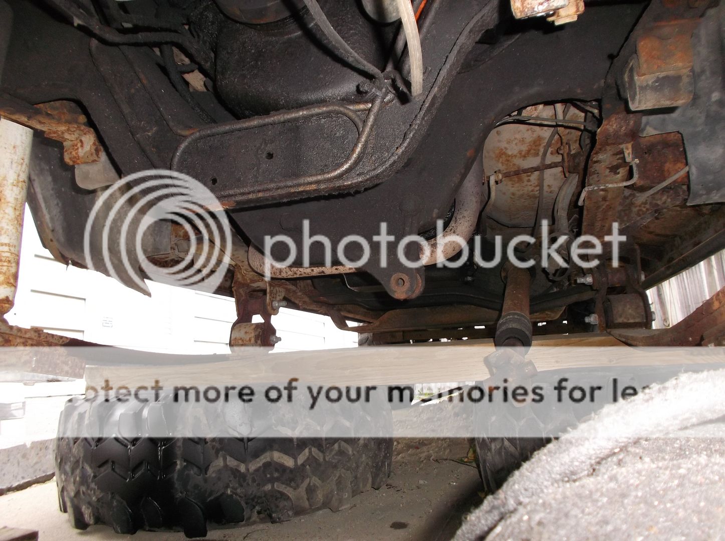

Its on the back part of the crossmember where it hangs down a lot, pretty much where the TTB bracket would be. Doesn't appear to have been used by the factory although its slightly bent from where it should be. I'll take a couple more pix.

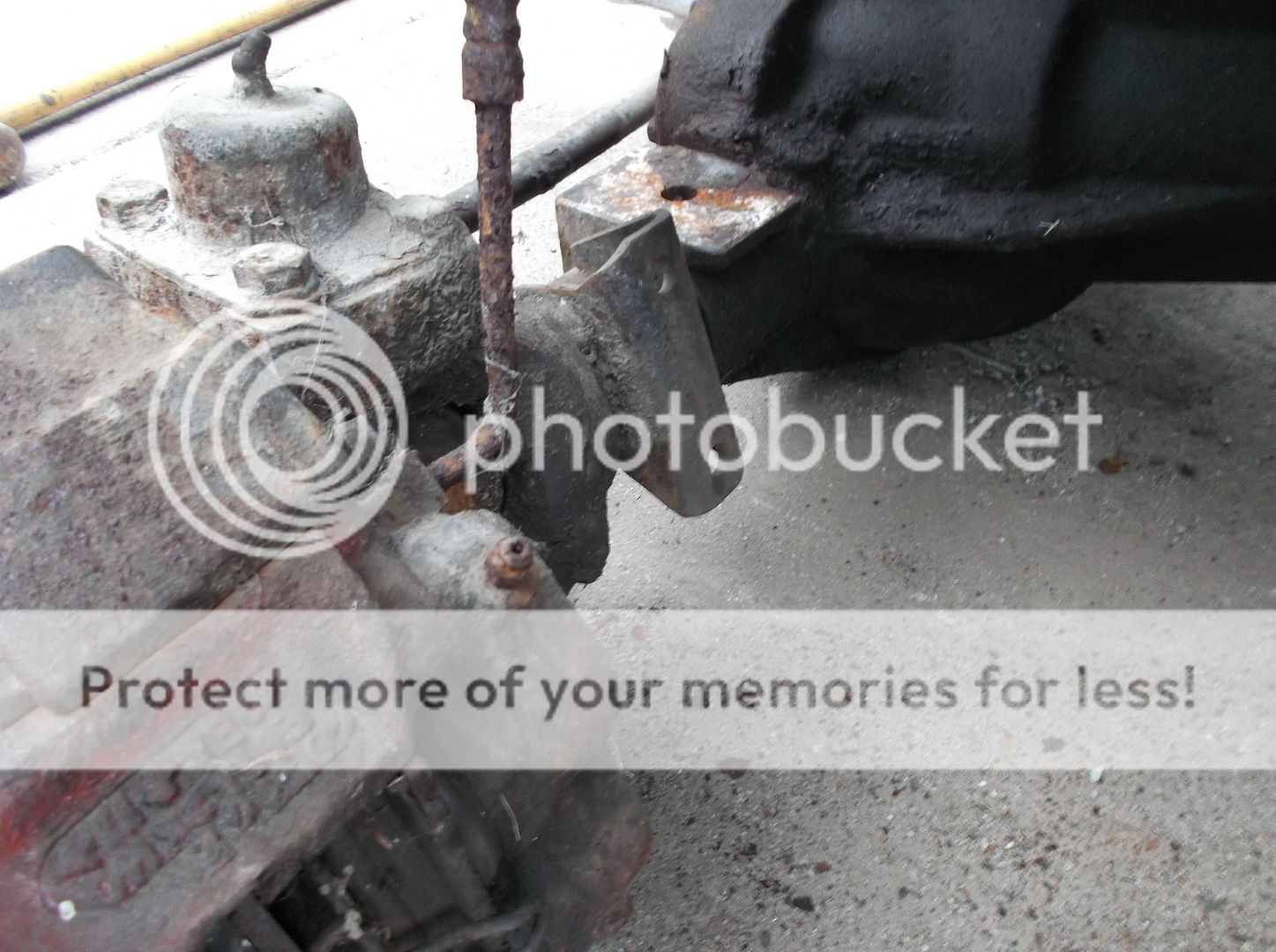

In looking at the pictures, it appears to have been used at some point but there aren't other signs of TTB having been mounted. You are probably right RockRanger, that there may have been a track bar mounted. I've added pix of extra brackets on the axle.
Right, under the axle.
Left, at the back of the axle tube.
Yes that is for a track bar/pan hard bar.
Looks like you got the cream of the crop! You found a King Pin D60.
That's the axle all the rock bouncers look for.
I'm pretty happy with this axle, Rowdy. It seems in fair shape so far and probably much heavier duty than I think I'll need. Although I doubt I'll be able to rebuild it without the big money parts anyways.
