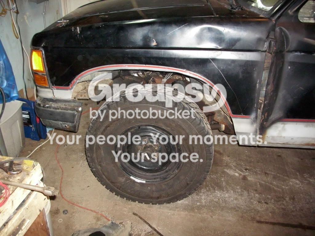

Here are your pictures. Its a small miracle I even took the pictures much less posted them. I need to get back to work ASAP!
Ride height, notice we have done extensive trimming.

not tryin to be an ass but looks like the core support bein rusted out greatly increases flex as well

I already did that. This is not my first RBV with over 10 inches of wheel travel.
Take a closer look at the pictures.
