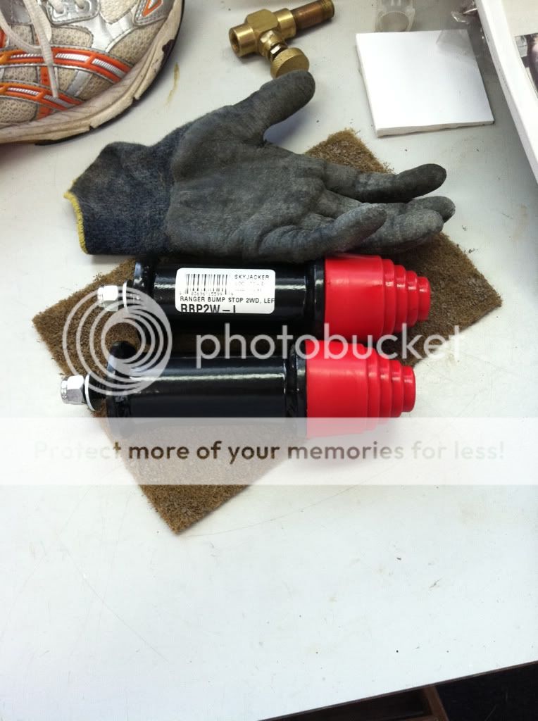

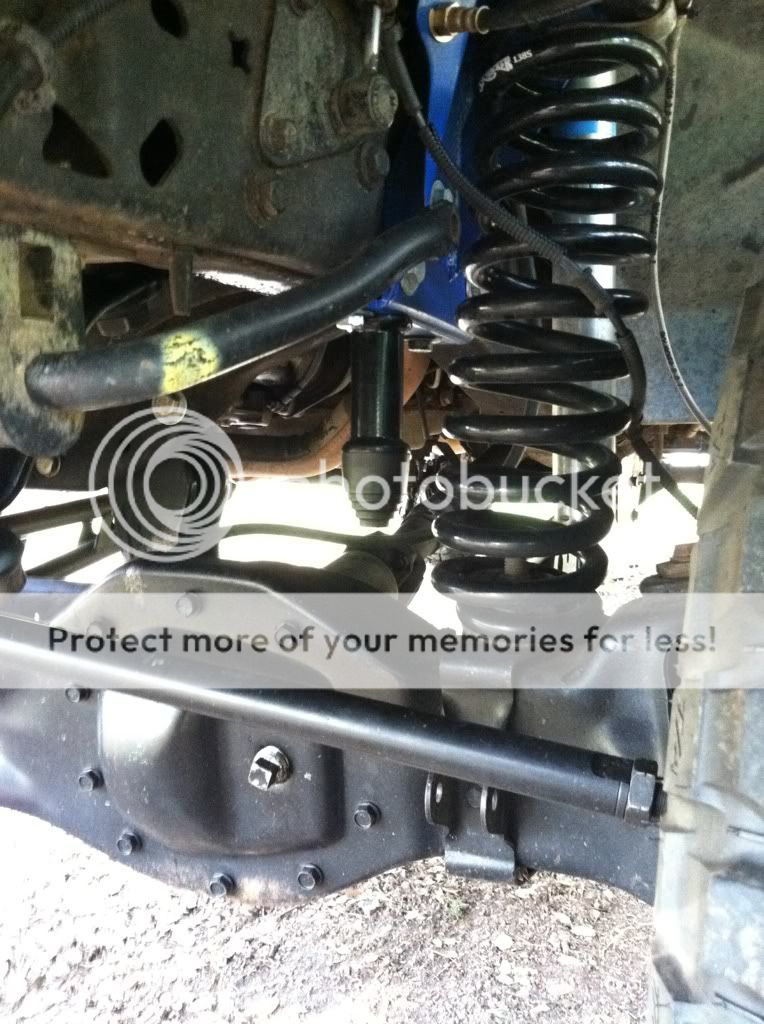

These came in the mail today. The Daystar ones aren't going to work for the front bumpstops without serious hackage...

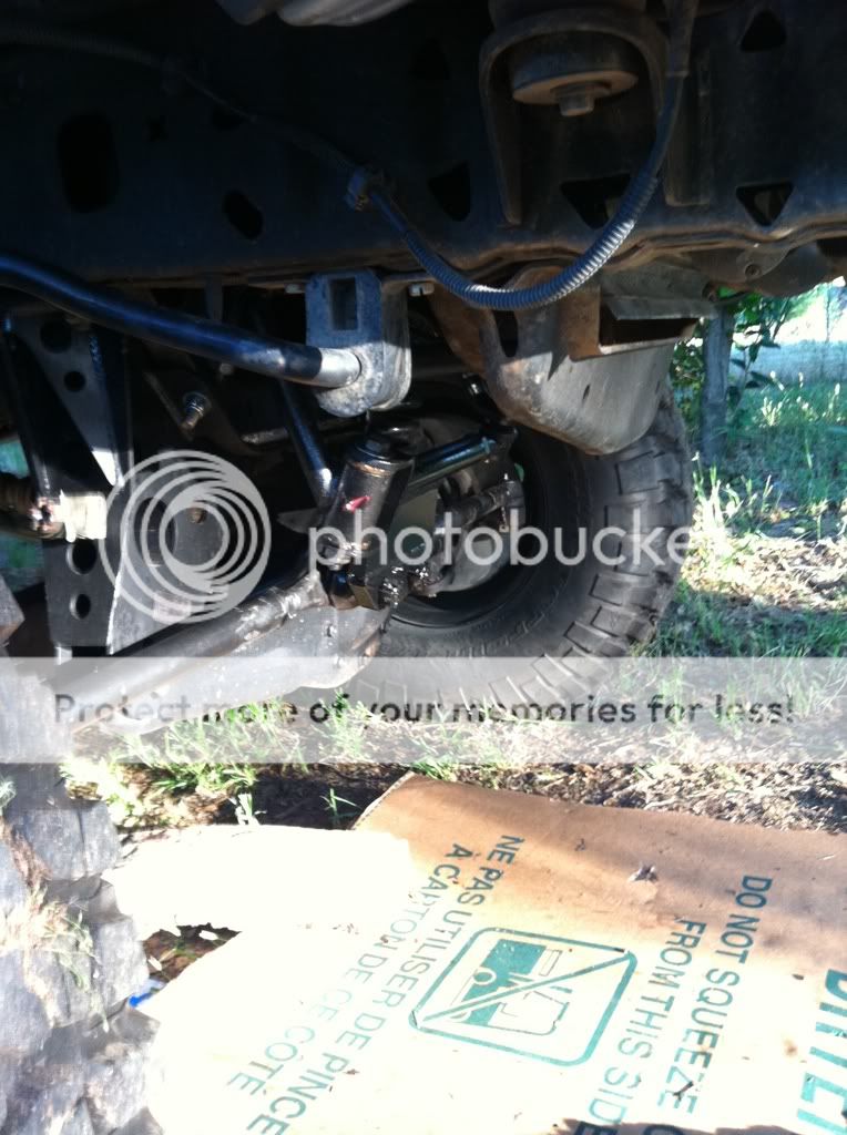

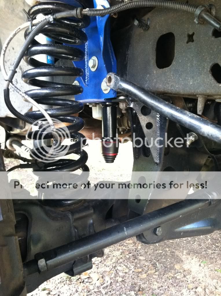

Got my front bumpstops on

question. you're front sway bars aren't hooked up, why do you still have the front sway bar?
B/c occaisionally I hook them back up when I go camping. Loaded down with gear makes the truck lean way too much around high speed turns.
Something you might consider doing, that driverside bump when it hits the beam there is no flat for it to hit on and you will ruin your bump stop if you ever hit it really hard. I had the same ones and tore because it slides off instead of compressing. I fabbed a little flat bump stop area on the beam and it worked great.
Build looks great!
that's what i assumed. i was planning on doing that, but i accidentally scrapped it one day, oops
Build looks great!
Good info, thanks a bunch. Next time everything is apart I will weld on a perch of some sorts.
I wondered if anybody has ever had problems with the drivers side bumps just for that reason, no flat spot to hit on.

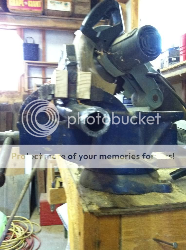

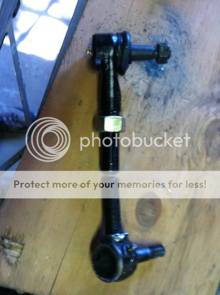

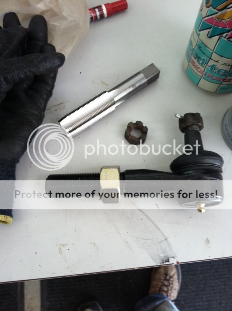

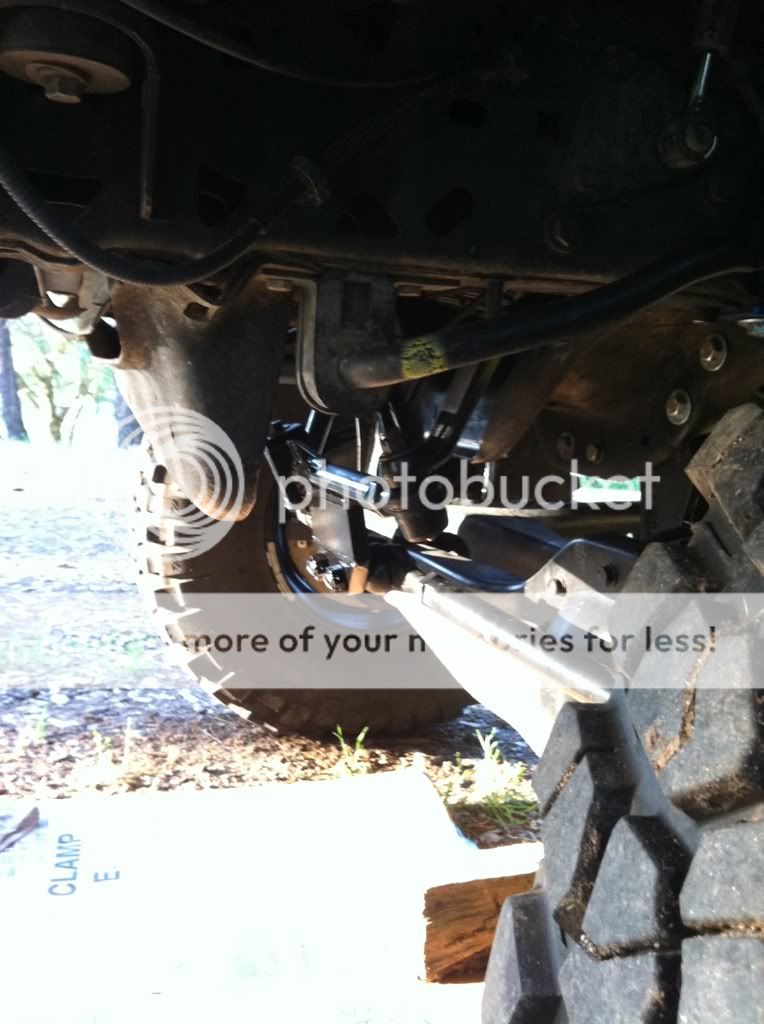

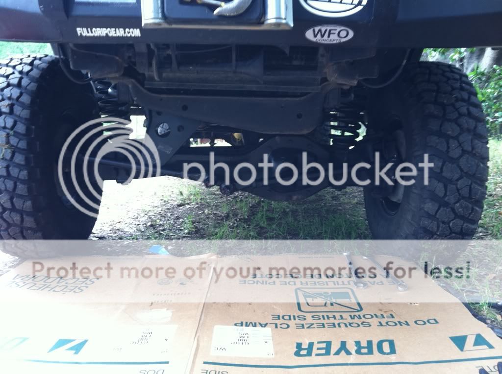

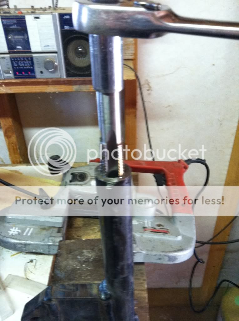

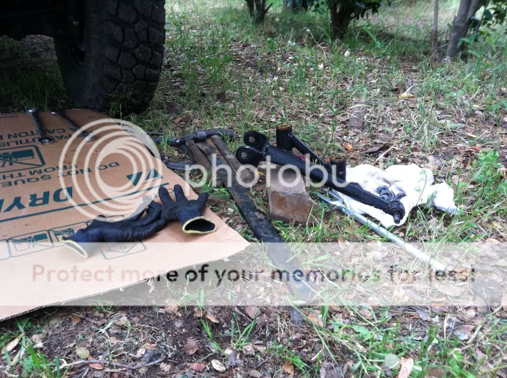

Modded the centerlink, dropped the pivots and tapped the end for a replaceable standard passenger side RBV TRE.

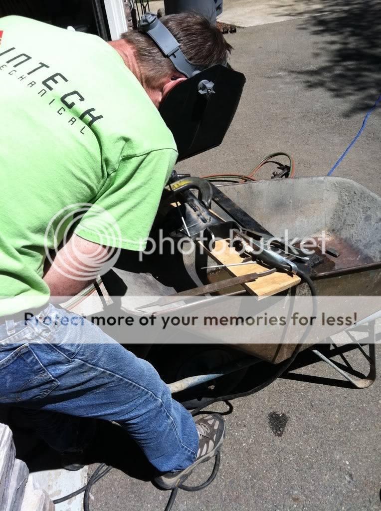

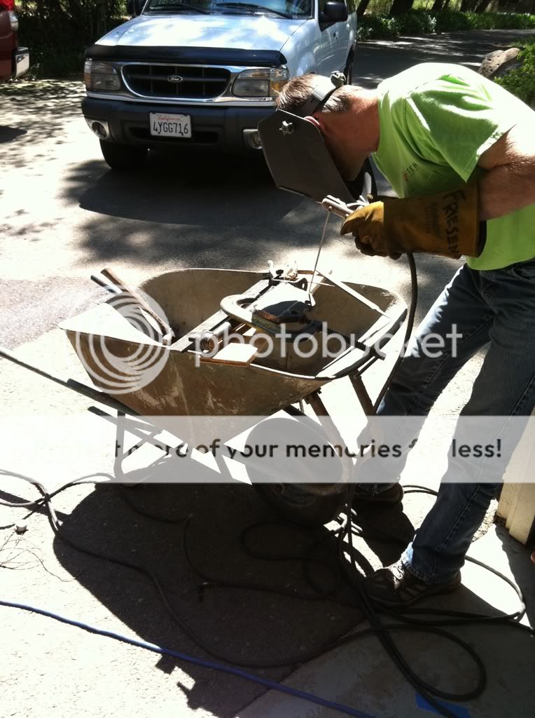

Dad doing the hardcore welding:

Took it for a test drive. Aside from the steering wheel being off center by a little, it drives AWESOME! NO BUMPSTEER! :icon_hornsup:
I am extremely pleased with the results of said modifications.

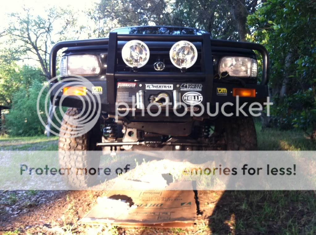

Next up is a custom, smaller diameter driveline this week, followed by an all aluminum radiator. Then followed up with a explorer ford 8.8 build. :icon_welder:

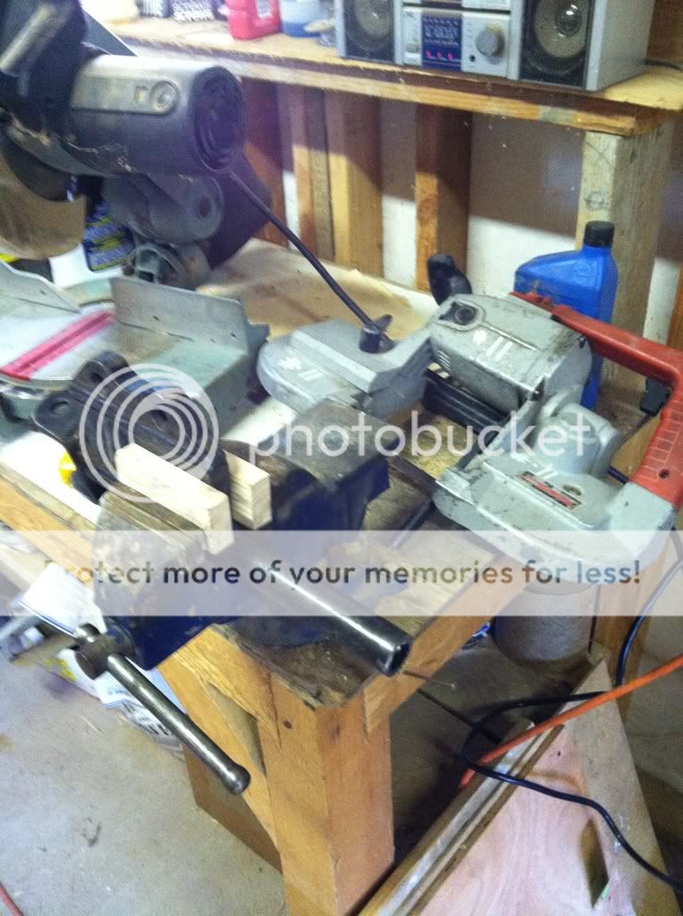

What the thickness of that drop plate. like 1/2?
Its a chunk of flatbar 2.5" Wide x 6.5" Long x 3/4" Thick

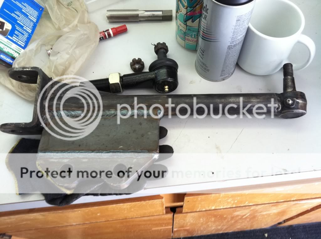

Fabbing a new idler arm....that will use standard sized Chevy leaf spring polyurethane bushings, this weekend hopefully.
