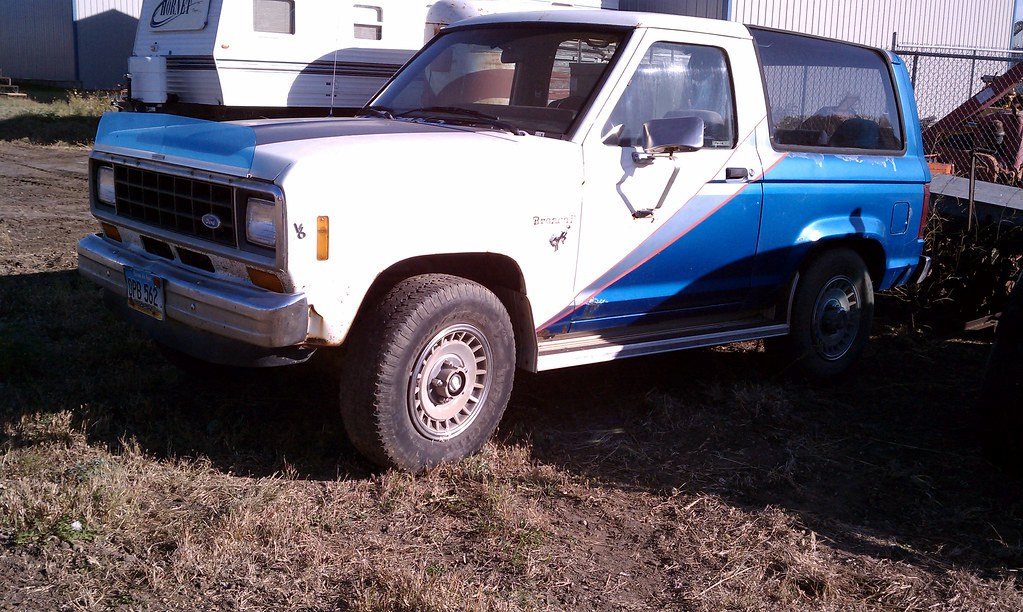

Well, my dad bought this one today:
I never got a chance to look at it in person, just the pictures my parents sent me. I have to pick it up this weekend and drag it home. It's got good and bad:
The Good:
$200
They were able to demonstrate that it runs by pouring gas in the carb.
Only surface rust, nothing too serious. I almost feel bad about cutting up the fenders to fit big tires, but I'll get over it.
The Bad:
Apparently needs a fuel pump.
Also it looks like it needs a slave cylinder at the least. You press the clutch pedal down and nothing. Doesn't even spring back into place.
The Ugly:
The 80s paint job burns my eyes.
The clutch doesn't bother me too much, I told my dad I would upgrade to a 4.0 clutch for him anyway.
Looks like a good place to start!
Thanks, I think it'll do the trick.
I have a good idea what parts I want to buy for the clutch and it's a pretty simple job (I just did this last winter on my Ranger).
I think the first thing after I get it running is to do the body lift and replace the body bushings at the same time. I'll probably pick up both from James Duff, seems like they're reasonably priced. Next, I'll move on to the body trimming and cheap suspension lift. Then tires/wheels. I've decided to leave the stock axles in place until they blow up. This will get him on the trail quicker and figure out what he does and doesn't like so I know what to upgrade next. I'm going to start looking at what other people have done for bumpers to get some ideas.
