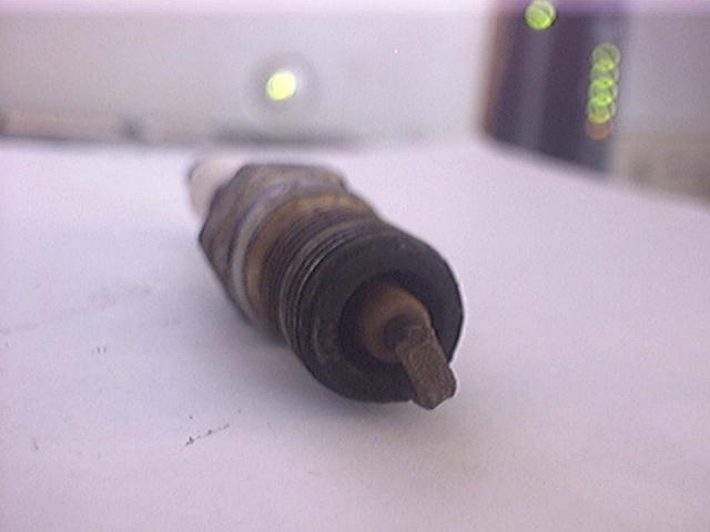

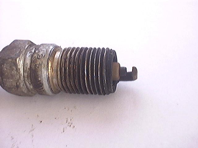

I checked my plugs, and took pictures of one.
rich mixture, high speed glazing?
