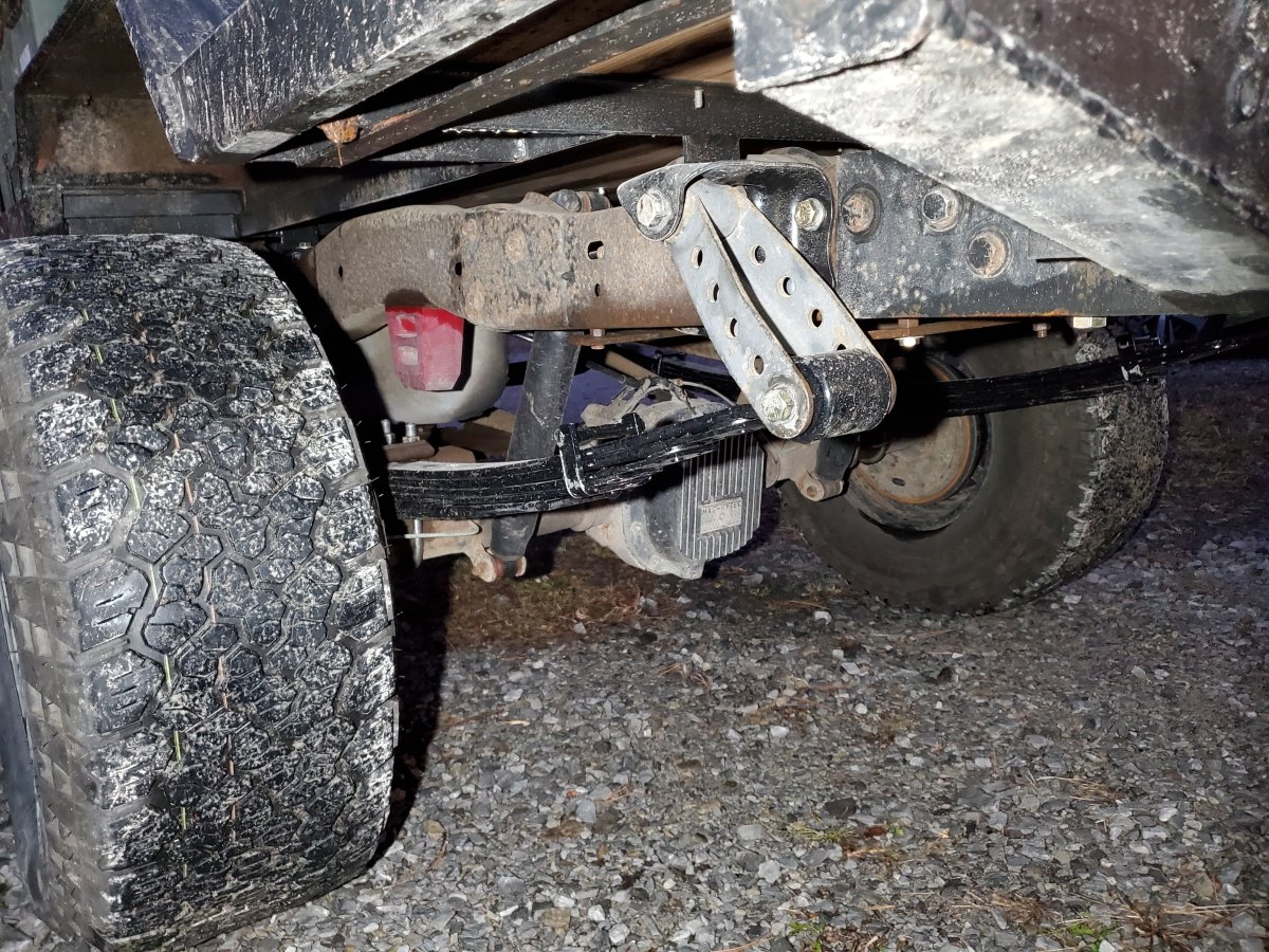

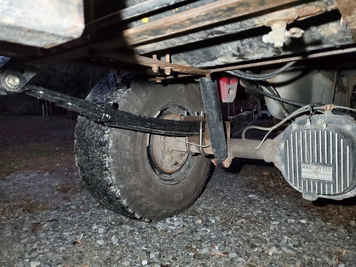

Got the springs installed in the truck, tried installing them without the huge overloads that they come with, they were too soft for my liking and I lost 1.5 inches of ride height. Disassembled and reinstalled the overload leaves and my ride height is now exactly the same as it was with worn stock chevy leaves and a 3 inch block, which is exactly what I wanted. I feared the overloads would make the ride terribly stiff but it didn't, hitting bumps is much more progressive than the old springs were which is impressive and I like it. Hopefully the same holds true off road and I don't get beaten to death any more than before on the trails. I have included a couple of potato quality photos of the springs installed.
Interesting... I think off road will be the test then (I was looking for flex a little more so than ride quality). If they restrict it too much, you could always play around with different OL leaves from various leaf packs (I don't recommend running without an OL at all though).

I wasn't running an overload before and it was alright but I've also got an antiwrap setup so axlewrap isn't a concern. I've got a set of stock ranger leaves with overloads which are way thinner, may get them re arched and swap to those if the need arises. I do tow and haul with the truck so it's a delicate balance as to what works or doesn't sometimes. I should have driven down to my local spring shop and taken a run up the RTI ramp before and after but didn't think of that until now, so unsure if they flex better or worse, time will tell
