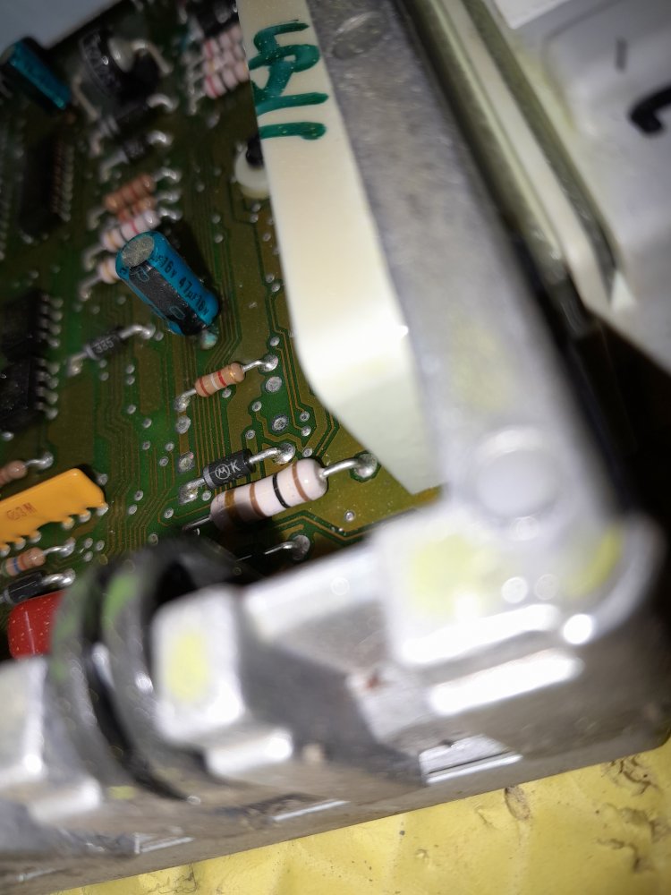

Not sure this qualifies as "miscellaneous," but I just pulled it to check on its condition thinking it might be the cause of my most recent issues.
Surprisingly, it looks really good. But your thoughts are welcome...thanks.
I'm going to clean it up a little and replace it
the capacitor on the right hand side looks like it may have failed, seems like there may be corrosion under it, unless my eyes suck more than I think
That right front capacitor doesn't look great. Looks like a leakage stain on the PCB from the rear leg, and maybe green corrosion on the front leg.
Yep...both right . I cleaned up with q-tips and alcohol. Here's what I think was the problem all along....
I do not know for sure at this point, but indications are that this was the culprit causing my problems -- fingers crossed.

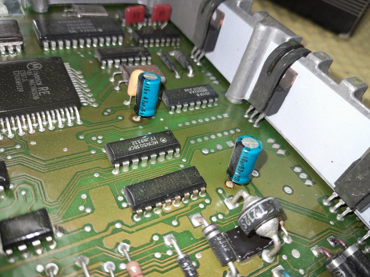

Looks like I need two 16V 47 uf and one 63V 10 uf. I will go ahead and purchase them (quick search found 3-packs through Amazon for around $5 - $6) , but for right now, I am going to enjoy the driving part. Now that I know how to pull it (20 minutes maybe) and what I am dealing with I am not so hesitant about doing it. I'm not really good at soldering, but capable enough to do this.
I still want to shakedown the truck to convince me that the problem is solved -- and give the wife something else to talk about ---wait di I just say that out loud?
View attachment 83659 View attachment 83660
This is the info with regards to the proper Caps I was looking for.
Two 16V 47 uf and One 63V 10 uf
