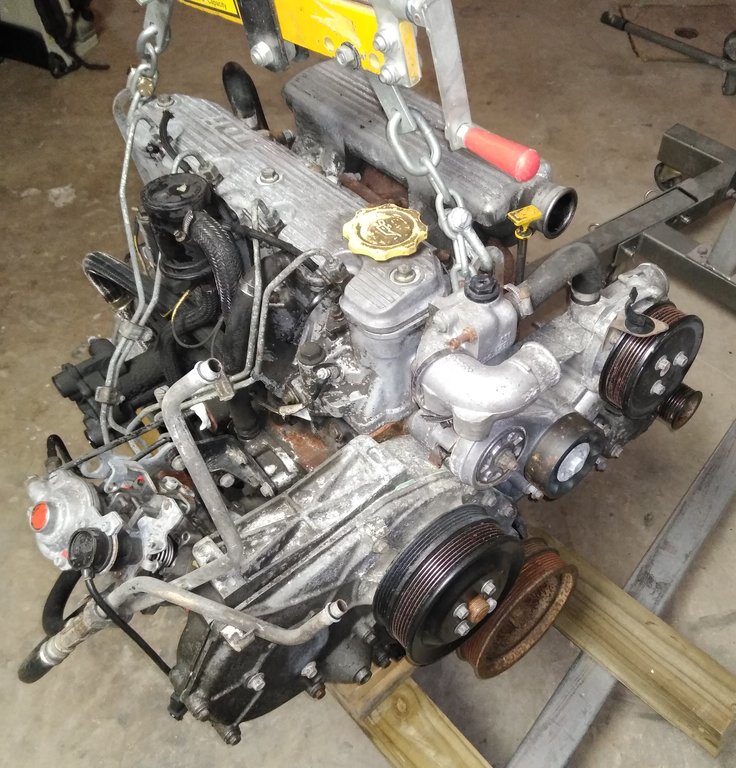

The transmission is out and cleaned up. Now the easy part is over. I was able to test fit the diesel engine in the truck. Once I got the engine in the truck it really becomes more obvious why there are some differences between the Land Rover and Ford Ranger engines. The easy difference is the oil pan. It will have to be modified to clear the front differential.

I'm still slowly plugging away at the ranger. I have had the flywheel modified to fit the original 4.0 transmission. It is now the same O.D., same starter ring gear, and clutch as the factory 4.0 flywheel. I also had to machine a custom adapter plate and build custom motor mounts.
I was able to source a OEM ford inlet and exhaust manifold, as well as the variable geometry turbo all from the 2.8 powerstroke. I was also able to source a radiator intercooler assembly.
It has taken a lot of head scratching and waiting on the machine shop to get to this point.
