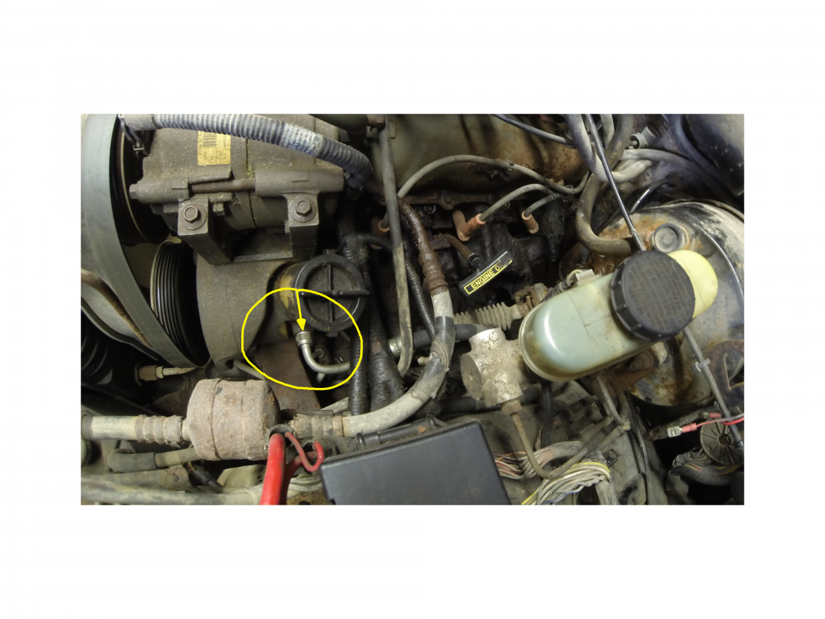

Before I replace the steering gear I need to flush the system prior to removing the gear box ( a required procedure to not void the warranty). I need to remove the inlet line at the reservoir. There's only two lines and I think it's the one I have circled in the image - yes I know it's a dumb question. I could just pull it off and find out, but I'm bored...
So did I guess right?

The line you have circled in the pressure line. The return line connects to the bottom of the reservoir (to a plastic fitting). I think the return line is the one you want to remove for a flush.

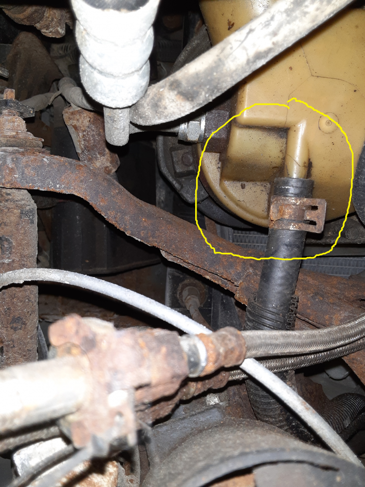

Yep, the return line is the one. Hard to see from the top, but it's this one, taken from the back side - of course it's the one that's hardest to reach:p
You might want to disconnect it from the gear box. The reservoirs get brittle with age, and it’s easy to break that connector off. If you’re replacing hoses, I’d cut the hose off that plastic connector and not do anything to try to pry it off.
