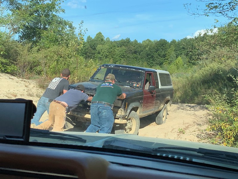

So here's photos of when I got stuck in sand, @AgPete139, @Mightyfordranger, and @85_Ranger4x4 pushed me out.
The engine wound up overpowering the clutch, and it smoked like a smoke grenade. Next stop, 10 inch clutch upgrade.
Sincere thanks to all three for helping out, and @85_Ranger4x4 for the photos. Any chance you have one of my clutch burning up?

I SERIOUSLY doubt your engine is making that much more horsepower than stock. The more likely scenario is that the clutch/pressure plate was already old and in need of replacement..
Something was weird with it too, it is like he has an abnormally high reverse. Sand was definitely a power sucker too to try to get going in. I was in 4lo and chugga-lugged around fine but I could tell I had more drag than normal.
I also wonder if his rear wheels fell into the holes I made. I kinda putzed into it in 2wd low range and dug two holes about where he got stuck. I put it in 4wd and crawled out no problem and then he followed me.
Not sure (sand is an alien thing to me) but I think 4lo would have helped PetroleumJunky a lot.
Both new in February. Luk heavy duty.
Need to hit a dyno at some point.
And yeah, it's the weirdo 2.9 M5OD-R1 trans. The reverse gear is way too high. I also totally forgot I had low range. ?

Being relatively new doesn't mean much though. Did you also have your flywheel re-surfaced, and did you wipe it down with solvent before installing the clutch disc? Was it a parts mix-n-match when the trans, flywheel, and clutch was installed?
I'm not trying to rag on your mods at all. I just don't believe that a simple intake change and a different engine management system will make enough extra power on a little 2.9 to smoke a new clutch that quickly. I follow similar mods on the 5.0 and know what the various intake, throttle body, and EEC swaps do for performance, and that can be easily estimated with the 2.9 as well.
I wonder about full engagement pressure, mixing parts, clutch disc installed backwards, etc..
It'll be interesting to see what's up once it's all apart.
