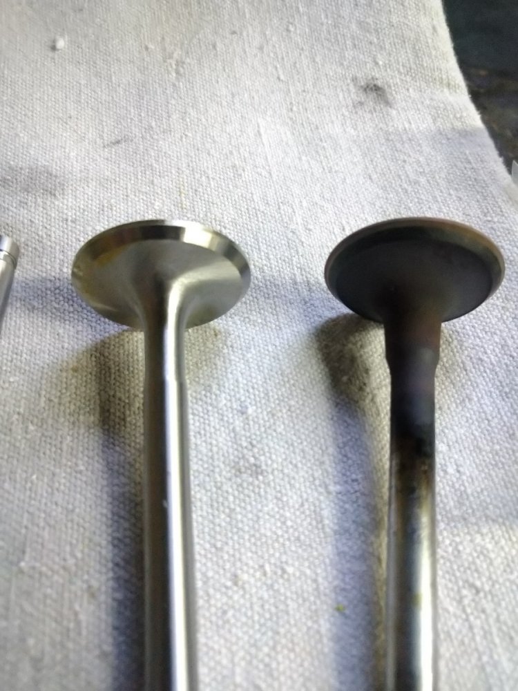

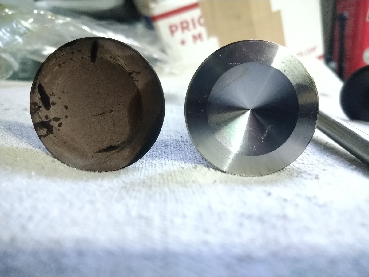

Just some comparison shots of the valves I picked up for my build. Due to a shop incident, flow numbers are going to be a little delayed.
However, for reference, side by side comparison of valve choices. The SI valves are around $170 for a full set, not far off from the cost of factory valves. Flow increases are supposed to be around 35%. We shall see...
Part numbers are:
SEV-3489 - Intake valves
SEV-2012 - Exhaust valves
