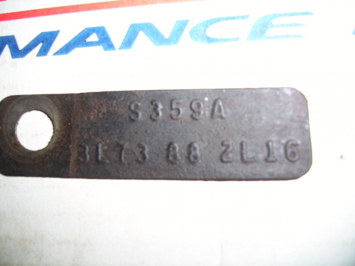

here is a picture of the tag on the rear end
70422
3 "L" 73 means 3.73 ratio with Limited Slip
3 " " 73 means 3.73 ratio but OPEN type
