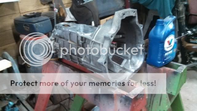

Case all cleaned up.

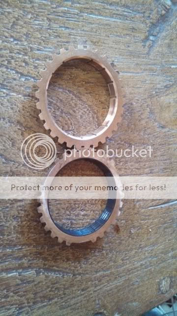

Old synchro compared the updated coated one

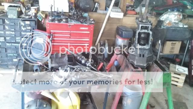

3 trannies apart at once....what could go wrong?

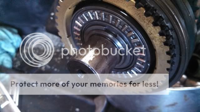

Hard to see in the pic..but here is the trashed nose on the output from the first trans.
PlumCrazy's OG Build
It feels like 60 grit and has lobes.lol
Im taking all the stuff I am using to work to clean it up in the parrs washer to assure there is no junk in the needles.

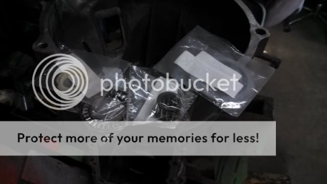

My first wave of trans parts showed up, the rest of the bearings should be here by Friday.

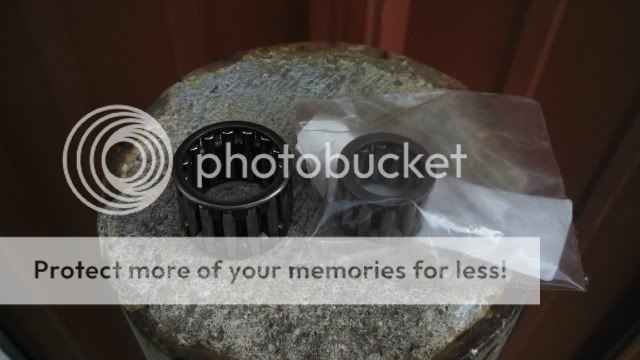

The pocket bearing was incorrectly packaged, but Cobra Transmissions has awesome customer service and were able to throw the correct one in with my second order that was shipping out, so it doesn't hold me up a bit.
I strongly recommend them to anyone rebuilding a trans or tcase. They have unbeatable prices and carry all the OEM bearings for our trannies and cases.
