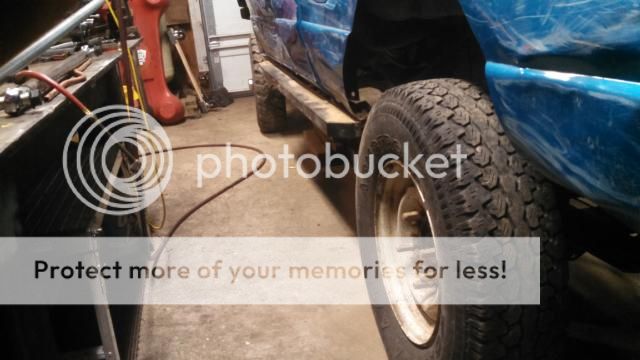

Not a whole lot happened this weekend as usual...ended up putting axle seals in Dads 07 Ranger and finding his rear shackles are toast. I thought Ford had fixed the flaky coating issue by 07, but apparently not...
I did however manage to bolt up two rims and align them so that I could cut/weld the tierod the drag link. I checked clearance of the pitman at full lock and it looks perfect.
PlumCrazy's OG Build
Next item is the track bar...Looks like I will need to build about 4" off the axle tube and 4" off the frame rail to get me parallel with the drag link, but....that will get me into the diff housing, so I am going to need to put a bump the track bar to clear at full stuff.

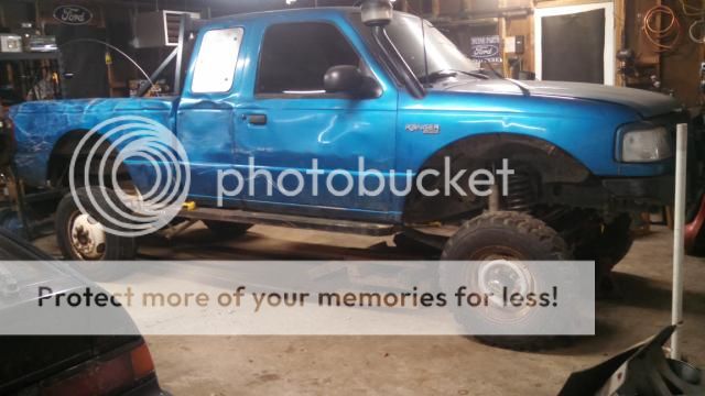

Bolted the 8 lugger under the truck just so I can move it around. Looks like I will be pulling the engine so I can get the cross member reworked. I hope I have a pair of wheels that hold air to roll it on.lol I might have to throw the dually spare on one side.lol

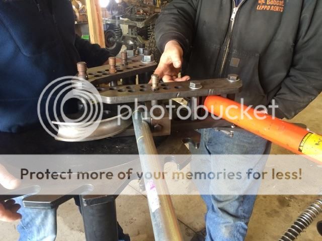

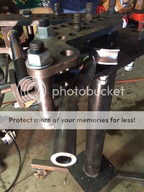

Then I stopped by Brads (036speed) to try out the bender (JD Model 4 w/ air over hydro). I found some 1.25” conduit with 1.5” OD to test on. Once we figured out where the bends start and how close we could get them to one another…we stuffed the .25” wall in and gave it a try.

It bent it like butter and turned out pretty good for a couple rookies.lol

It will fit perfect from the looks of it. I have an extra 3-4” on both ends so I room to wiggle with my brackets.

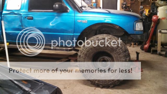

Bolted up some rollers so I can get the Ranger in position to yank the engine out and get cracking on the crossmember….I think I might just stick with 28” skinnies….lol

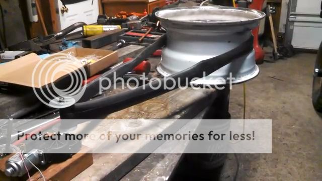

Played around with making a fixture for welding the rim centers and beadlocks. I want nice uniform beads, so I plan to tack the tings in 6-8 places to control warping, then I can full weld them.
I started by lagging a spindle to a 2x8 and then dropping an old 5x5.5 hub on it. I scrounged up an old post test recliner motor from a seat at work since they are single bolt/stud mount and have like 300:1 gear ratio. I then bolted it down and make a crude "pulley" with a section of the recline drive shaft and a few fender washers tacked on. I used an old bicycle tire tube with a the valve stem cut off for a belt. (thanks Brad)

I need to find an old headlight dimmer switch to use for a speed control. I think it may be a touch too fast. I have an old 15" rim to test on.

I want to make something similar for welding links and tie rods too. I originally was thinking I needed a much slower motor..but the surface speed will be the same regardless of the diameter of what I am turning...the rpm will be the same, but the outer diameter is what I am welding so that's where it counts.
