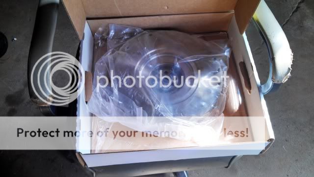

Wooster just does torque converters for Autotragics.lol
Clutches and flywheels come from Mexico.
I had a few instructors at ATI that worked at Luk......They get a nice employee discount on 3 clutches a year. I saved over 50% on mine.lol

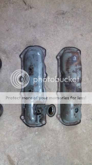

Did a little work on the valve covers.
I removed the unneeded clip a brackets, welded up where the spot welds left holes

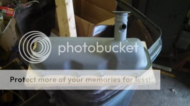

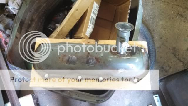

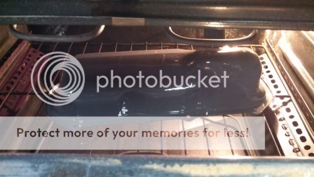

Removed the extra clips and brackets. Welded up the holes left by the spot welds.
PlumCrazy's Build

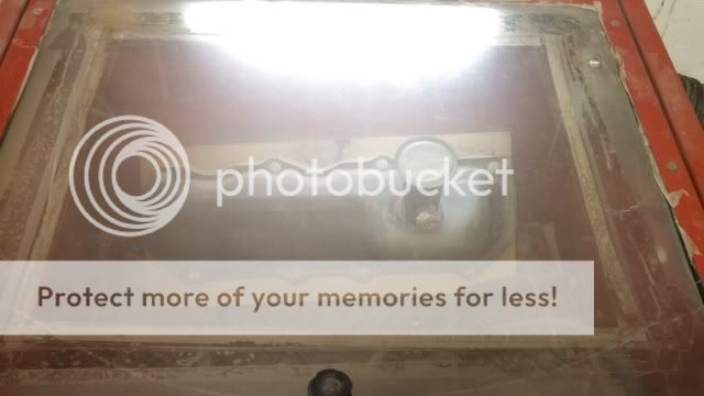

Screwed them down to a piece of wood and taped up the openings to keep sand out.
PlumCrazy's Build
Sandblasted them.
PlumCrazy's Build
PlumCrazy's Build

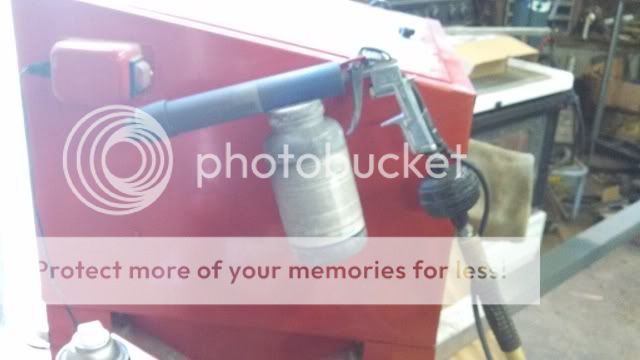

Shot powder.
PlumCrazy's Build
PlumCrazy's Build

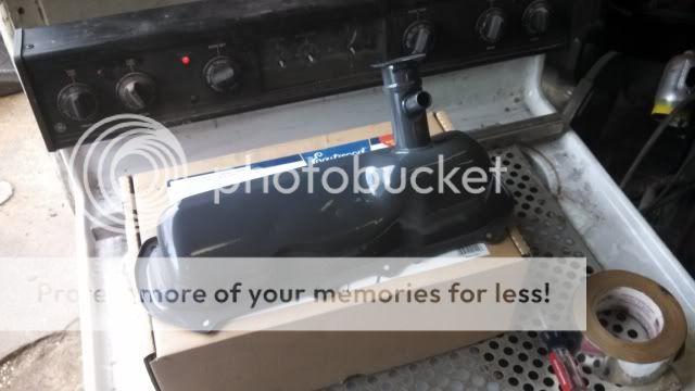

Baked.
PlumCrazy's Build
And done.
PlumCrazy's Build
Sent from my XT907 using Tapatalk 2
