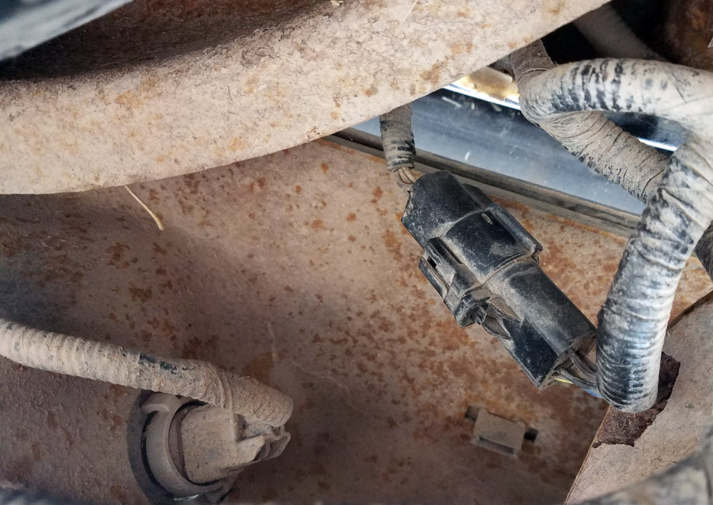

Hello!
Upgrading my 2003 Edge so that I can tow my new Airstream! I have the towing package already, but was curious if my truck should have the plug / wiring already set for 7way plugs? It has a flat 4 that I had to install (had the receiver, tranny cooler, etc. Already installed), but I need to know if I just need to buy adapters to hook up with the 7way plug (in the rear) and the brake controller (under the dash). I have read that both should be there, but all I find underneath the back is the connection show in the photo. Can I plug into this? It appears to go right to the brake lights......any help is a appreciated!!

AFAIK No ranger based vehicle came with stock wiring to permit a 7-pin plug. I've installed a few tho. You have to run a blue brake and a red 12v +ve from the front to the back. If you want reverse lights a relay might be best, depending on draw. Some 7-pin kits come with a plug for the 4-pin flat.

This is the plug I put on my GMC. Very happy with it, good to go with the flat 4, flat 5 or 7 blade RV. I had a similar 4 way plug like yours before, I just cut the end off (enough that I could solder it back together if need be), and fed the wires into the housing along with all the other extra ones for the 7 blade.

Some Explorers got a factory 7-pin. No Ranger.
Just get a flat-4 install kit and a 7-pin kit that plugs into the 4-pin. It will get your lights on line at least, then you only need to do breaks and 12V aux.
