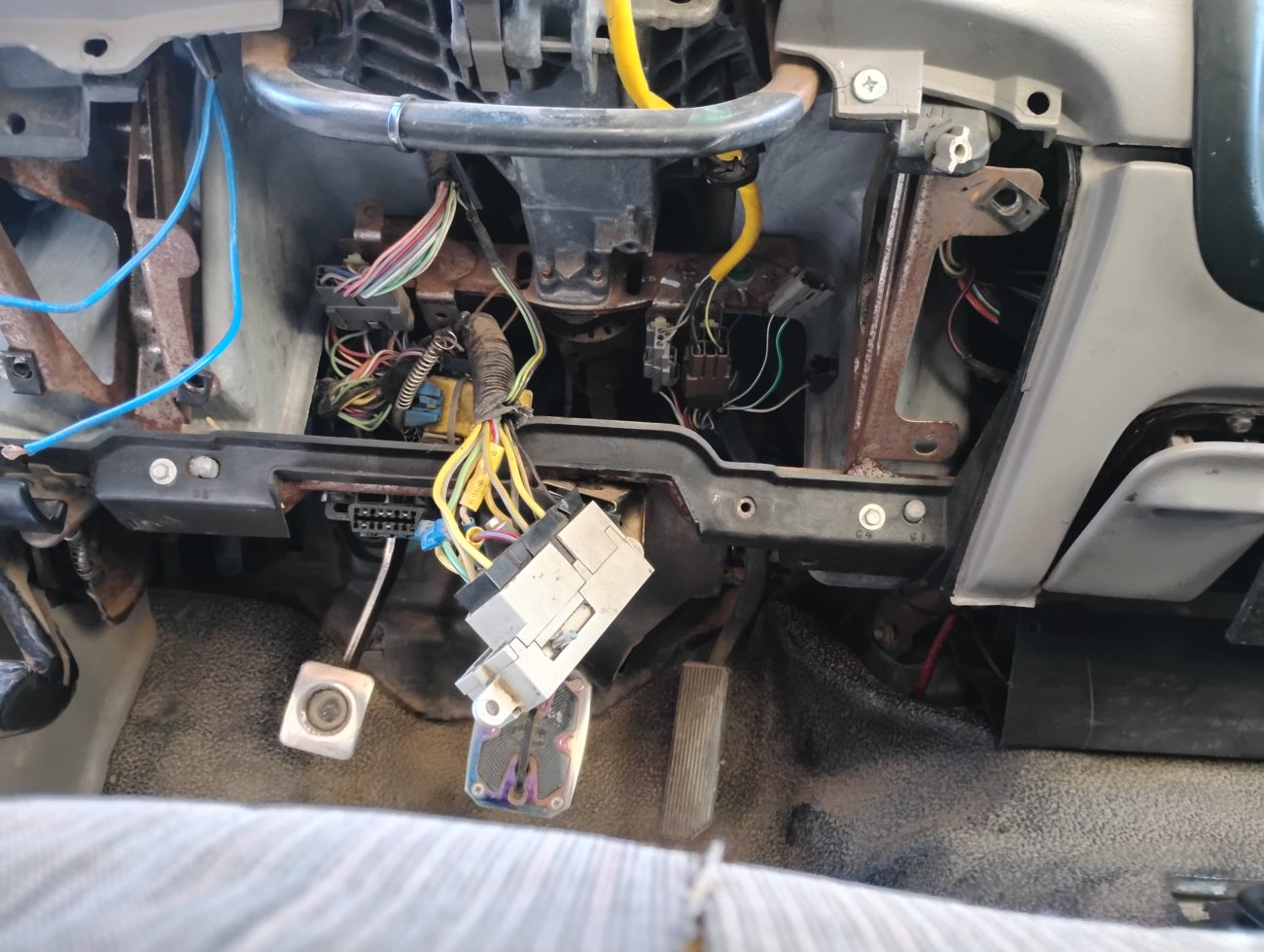

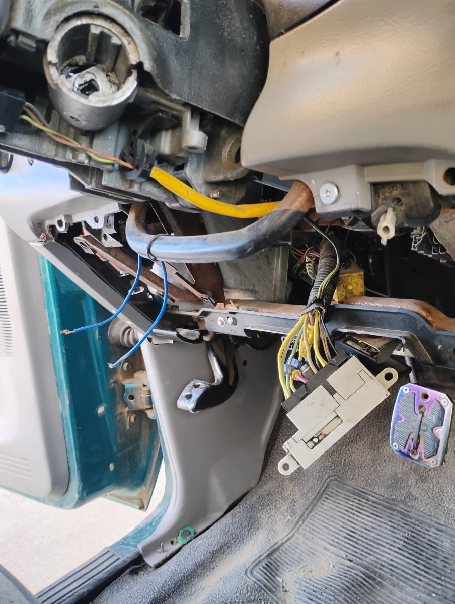

This is what I'm dealing with. As you can see, the problem isn't something stuck. Most of it is non-existent. I have no way to know what isn't there without an exploded diagram of the complete column (and more) assembly.

In your pictures, the white box is the electrical part of the ignition switch.
Best case scenario, if you repair the ignition key cylinder that got pulled out (that is the mechanical part of the ignition switch), if the linkage rod is still good, and the electrical switch is still good, you can just put everything back together.

I would not install hood pins myself. Go to the boneyard and get the complete cable assembly and usually new hood latches are not very expensive. Once you find a truck in your generation in the boneyard, you will start seeing all the parts you are needing. Get everything back to factory. From your picture, the key ignition looks to be ok and you can just get a new key set and get it working fairly quickly. Once you get those thing sorted out and your igniton box, hanging down and in the correct place, some of your electrical issues might go away.

1995 had a major redesign of the dash; I'm not sure what, if anything, is compatible as far as the steering column and dash from the 89-94 design to the new design starting with the '95.
The big change for '95 was the addition of a driver side airbag, which yours looks to have based on the yellow-sleeved wiring harness running up the column.
I've never had one newer than the '94 models, but I've seen comment that the '95's have certain peculiarities to themselves.
Your best bet may be to focus on getting '95 model parts for it, where needed, with '96 being second. I don't have much faith that '93-94 steering column parts will be compatible with a '95.

Good info R> I didn't know that. I noticed the yellow covered wiring though.
