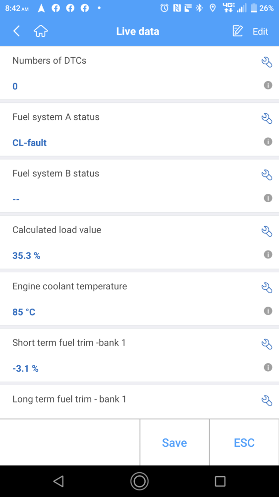

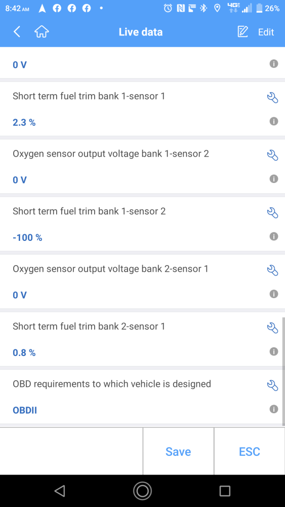

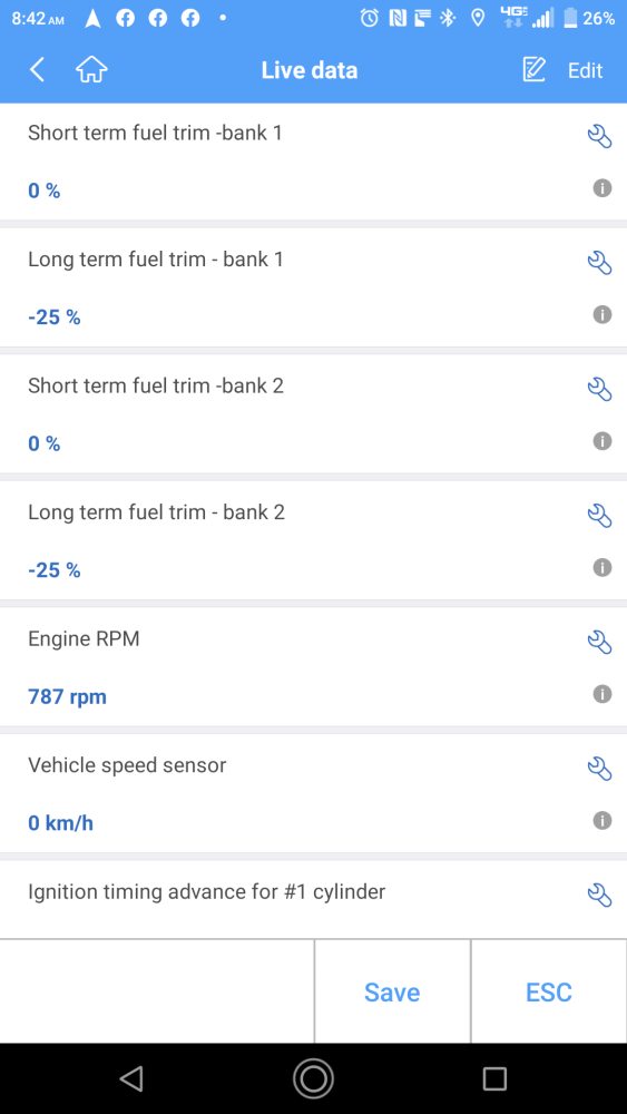

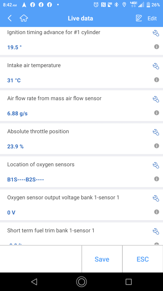

Here's all my #s at idle. Jumps around between 750 and 825 at idle. Right around 17 in Hg
MAF sensor is way off, at idle(800rpms) 3.0l engine should be 3.3-3.7 G/S, 4.0l engine 4.3-4.7 G/S
General rule of thumb for MAF is 1 G/S per liter of displacement at 500rpm
So 6L engine would be 6.3-6.7 G/S at 800rpm, and you don't have a 6L engine, lol
Throttle sensor should be 16-19% when throttle is closed, not a big deal, but 23% is wrong at idle
O2s seem to have no voltage, all are 0v, so none of the % are reliable
Fuel system A "CL-Fault" usually means computer can't do Closed Loop, from data shown it would most likely be from O2 sensors lack of feedback
Temps look fine
Spark timing is fine
Based on what Ron said, I'd look at the MAF sensor. They do get drty/go bad. Mine have more than once.
And the symptoms vary but all the same: truck runs, but like crap...and usually no CEL either.
Try key on engine off and look at MAF sensor data, should be 0 G/S of course
both TPS and MAF use the same reference voltage. a quick voltage check may be in order.
