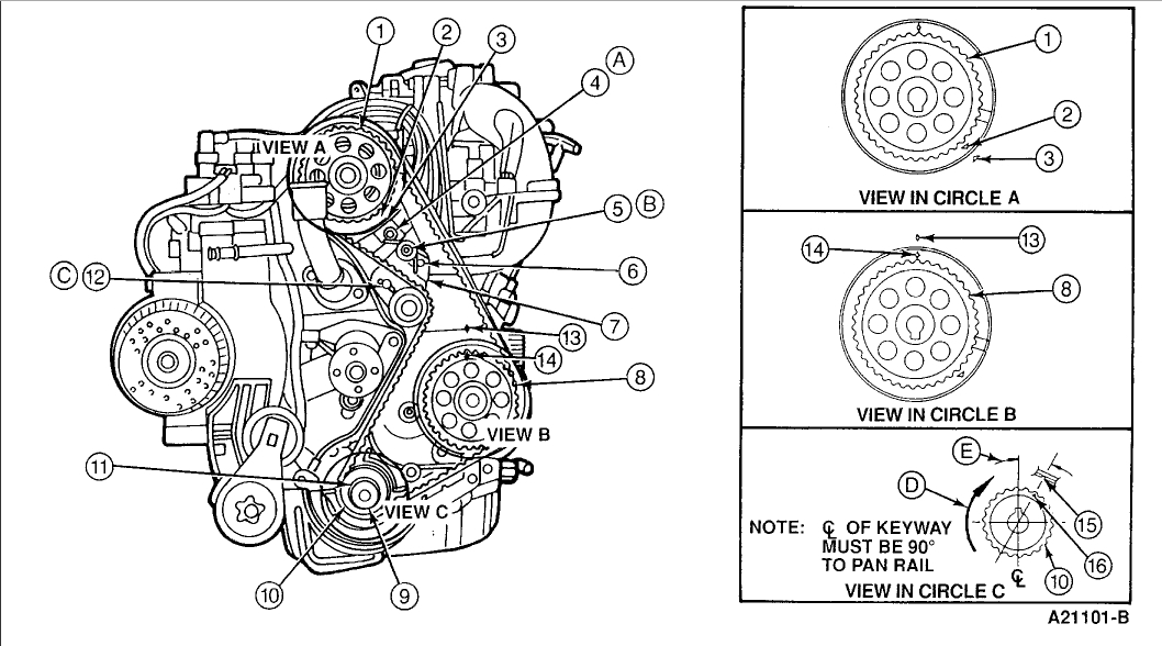

I have a 96 2.3. 150k miles, timing belt looked awful (deep cracks). I went ahead and replaced it. I watched a number of videos and have a Chilton's manual, but something still went awry. Truck runs rough, especially at low rpms, seems like a pretty hard misfire. No unusual noise. No Cel either after starting it and running it for no more than 10 seconds at a time, which I did maybe half a dozen times to see if the poor running condition was consistent.
I replaced the belt and the tensioner. I lined up all my timing marks according to Chilton's manual. Key on crankshaft was at 12 o clock position (at top), the dot on crank sprocket aligned with notch in bracket above it. Camshaft sprocket has a sheet metal disc attached to its backside, which has an indent in it. That indent was lined up with the triangle in the plastic backing piece of the timing cover. The oil pump sprocket (not that its position should matter?) had a disc behind it with an indent, like the camshaft sprocket, which I lined up to the diamond on the plastic backing of the timing cover.
I triple checked all these marks before putting everything back together. The belt was riding good (turned through several revolutions of engine by hand before allowing tensioner to put tension on belt). Belt did not have slack, tightened the bolts for the tensioner, etc. When all was tight, my marks were still good. The only thing I questioned at this time is that it was hard to get the indent on the back plate of the camshaft sprocket to center perfectly over the triangle on the plastic cover. It was off just a hair. But I tried changing its position in the belt teeth one tooth in either direction, and it didn't center the marks perfectly, the skew just changed directions.
Only other thing I replaced today was E C T (small two wire unit threaded into coolant line coming from thermostat) because I noticed it was broken when I was doing the timing belt. I did NOT undo the crankshaft position sensor or touch it at all. It wasn't in the way so I left it well enough alone.
What I find weird is that in every video I watch of someone doing this, it seems like each year 2.3 had different timing mark system. Mine made sense according to Chilton's but not so much to other people's videos, etc.
The other thing I find weird is that when I looked at the original timing belt and the locations of the timing marks as it was, it looked to me like it had jumped time. The crankshaft and camshaft marks were not in sync with each other (cam would be off its mark when crank was lined up or vice versa. like ridiculously far off).
Is it possible that my truck was timed quite badly before, and that the ecu is adjusting to proper time? Am I just a dummy and missing something obvious? What could I have messed up? I don't mind taking it all apart and investigating, but I have no idea what to look for at this point.
Does anyone have pictures of what my 96 2.3 timing marks should look like when lined up? Any ideas as to what I could have done wrong?
