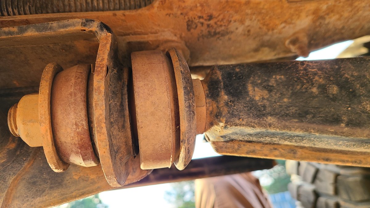

I ditched those spacers long ago. I have a miscellaneous piece at the forward end of the threads to try to push the axle forward. But it’s only 3/16” or 1/4” thick. If I remember, I’ll take a picture later this evening when I get home from work. Thought there was a picture in my build thread. But I don’t see it.
Here's a picture of my driver side. No plastic spacer.

is there any play in there? Doesn't look to secure?
I noticed when I took the picture this morning, that the bushings aren't compressed much. I'll revisit that over the next week or so. It has been working fine. I wouldntwant it overly tight because that may inhibit droop in my suspension. I like suspension travel. So, they need to be tight enough to hold position. But not so tight that things don't flex.
