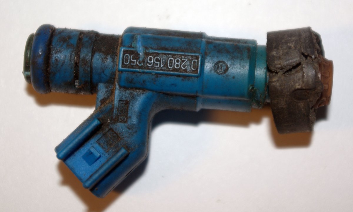

I was pulling the fuel injectors out of my 2004 4.0 and this plastic piece came out with one of them.
What is it, and how do I fix it?

It's the spacer.... you can get new ones....pop it off..and reseat if it's not cracked. Usually best to get all new o rings too
Dorman part number 926028
