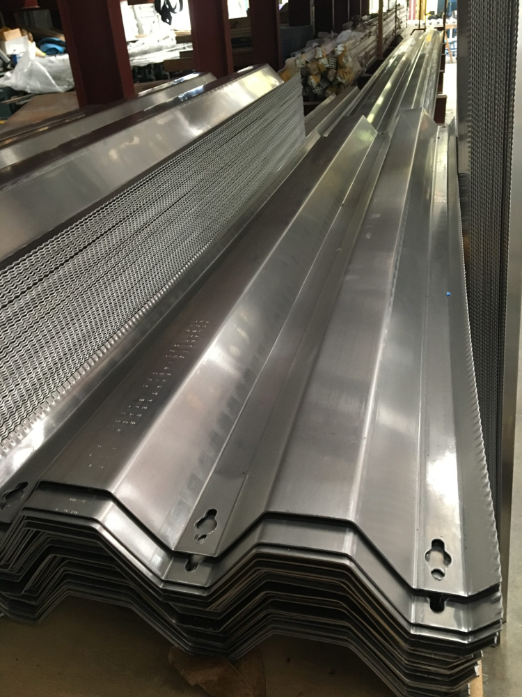

Does anyone have experience plasma cutting aluminum? I'm installing hurricane protection panels on my house and got a bunch of used panels off Craigslist from someone who replaced their windows with impact-rated. I planned to cut them with a cut-off wheel but found out they are aluminum. Aluminum panels are nice, but they don't cut well with the cutoff wheel. Because of the shape of the corrugated panel my power shears won't work and I was wondering if plasma would cut it well. I've been looking for an excuse to buy one and being it's house related it should be an easier sell to my wife. The panels are 0.050" thick and look like this:
The other option is a metal-cutting blade for my circular saw. I can do that, but it's unlikely I'll cut much more sheetmetal like this. I think the plasma cutter would get more use in the future.

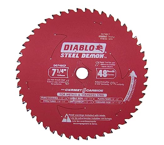

just buy a metal blade for your circular saw.
they make them now....they are worth twice what they ask for....the ones i use on my chopsaw are just awesome. its so nice to have consistancy with waaaaaaaaaaay less mess.
