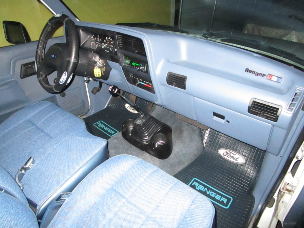

I love the way my Hurst shifter shifts and looks. The noise isn't bad. I just noticed a fluid leak from the shifter area. I see this is a old topic. Is there any new information on the best fix for this leak ?
