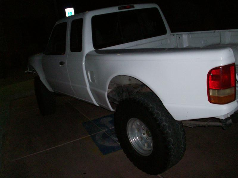

Hey, I was just wondering if anybody could post some pics of thier 89-92 Rangers with fiberglass quarters and 35's.
I really wanna get the prerunner look, but I dont want to spend an insane amount of money. So I was thinking 35's, 4" suspension lift, a little body lift, and fiberglass quarters. My truck is, 2WD and *for now* 2.9 and auto :/
But have no worries, when I blow up the 2.9 for good, it's gonna be either 4.0 and 5 speed, or 302 and T5 driven!
here's mine....

If you want the look, but dont want to spend the money, then get a drop bracket kit and stay away from a body lift. The 4" lift you are talking about will net you enough room to squeeze 32"-33" tires in. 35's might be quite a bit of a struggle on that drivetrain your speaking of.
35's will go with the right rims but be sure to set your bumps lower so that your not bashing your fenders all the time. 33's would be a much better option because they still loook huge and they clear alot better.
I think there are clearance issues with an original firewall and 35's. True??
i never had an issue with the 35's.. but didnt work well with my suspension travel
No issue but they did not work with your rig? that sounds like and issue to me LOL
