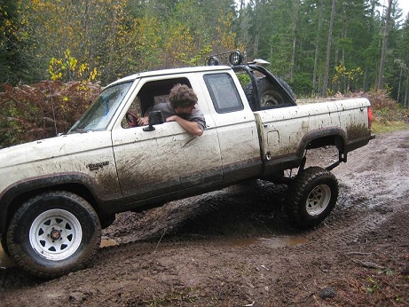

Started off as a Duff Stage 3 kit that I have since changed a little.
I added Belltech shackles in rear,2" shock extentions up front,Skyjacker Softride 6" Jeep XJ coils with homemade coil pads, 8.8 swap with modified shock mounts.On 35's.
