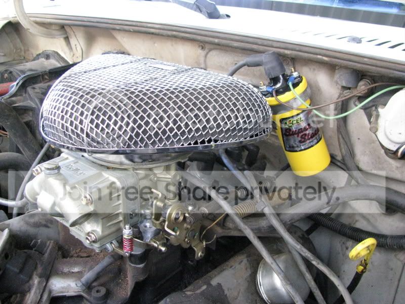

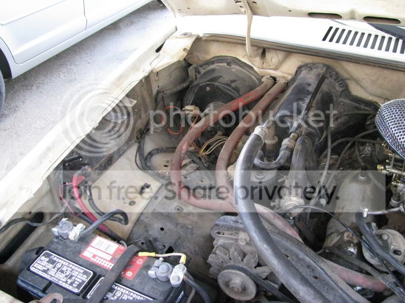

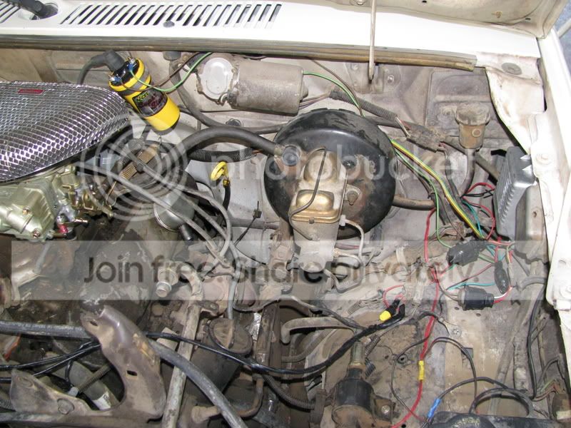

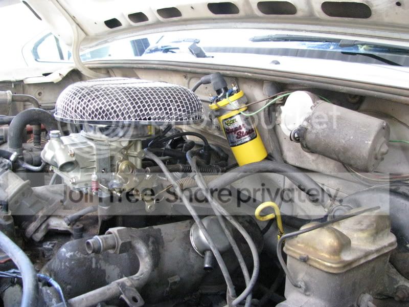

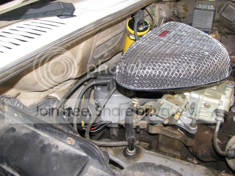

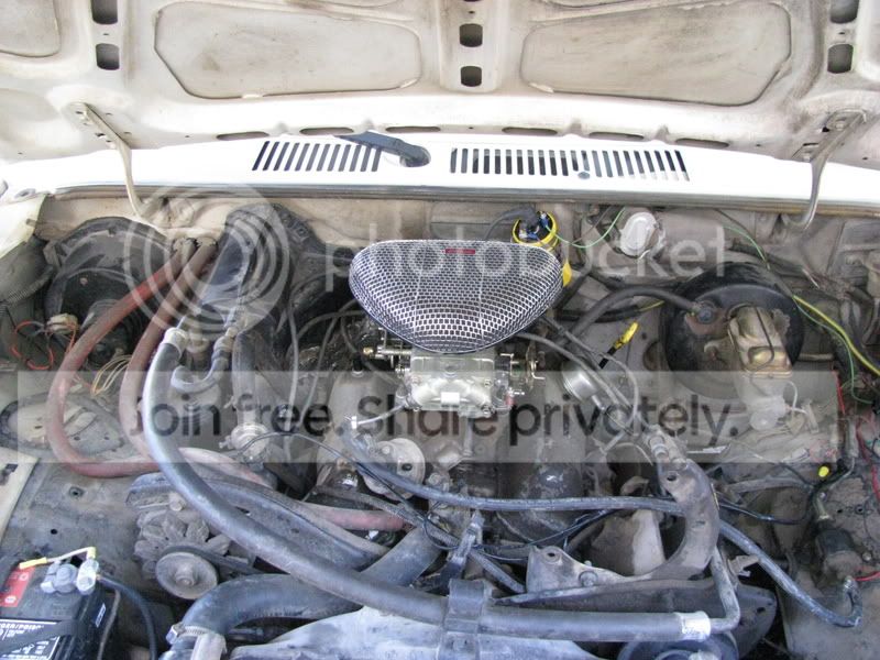

Just thought i'd share some pics of my DSII swap. I'm running the holley 2300 350cfm, Duraspark control module, and an accel coil. Please excuse the dirty engine, i've been wanting to wash down the engine compartment ever since i purchased the truck but I was affraid I would short something out with all the wires that used to be in there...I'm not gonna have that problem now :D Since the swap my city/hwy mileage has gone from 19 mpg to 22mpg...I'm hoping with new plugs and bigger wires my mileage might increase...
Good work,if i would make one suggestion,get the valve cover breather into the air filter somehow so the engine breathes right.Congrats on better mileage,what jets are you running?
I'm running whatever jets came stock on this carb(new out of the box)...Thanks for the kind comments, and i'll be sure to hook the breather back up...
Okay that would be #61 jets.
I like it. Now make the engine bay as clean as the rest of it :)
