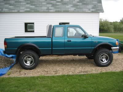

1993 Ranger 4x4 4.0L 5spd explorer rear
6" skyjacker class 2 lift with their lift springs and stock block in rear. 33X12.50R15 on 15X8.
Fenders are only trimed in the back corners of the front fenders.

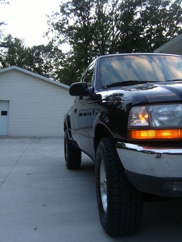

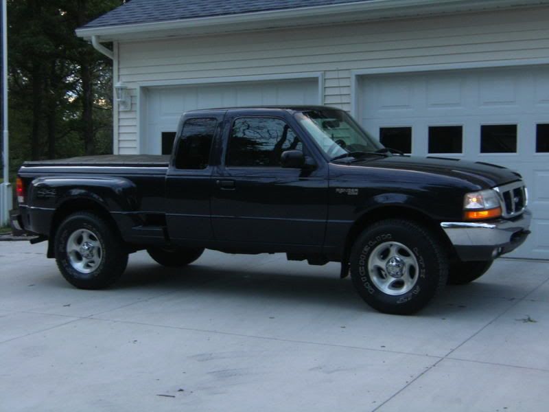

1999 Ranger XLT 4x4
Torsion crank up front with stock lift block in the rear
265x75-R16 Michelin LTX AT's
Trucks shown sitting are the best shots because they show the true distances between the tires and fenders. Vehicles in action or flexing are deceiving since the tire could actually be moving away from the fender.

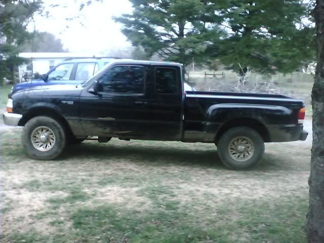

1999 stock height no cranking or anything with 31x10.50R15 with no rubbing at all .. if the pic needs to be better i can find the digi camera and take better one

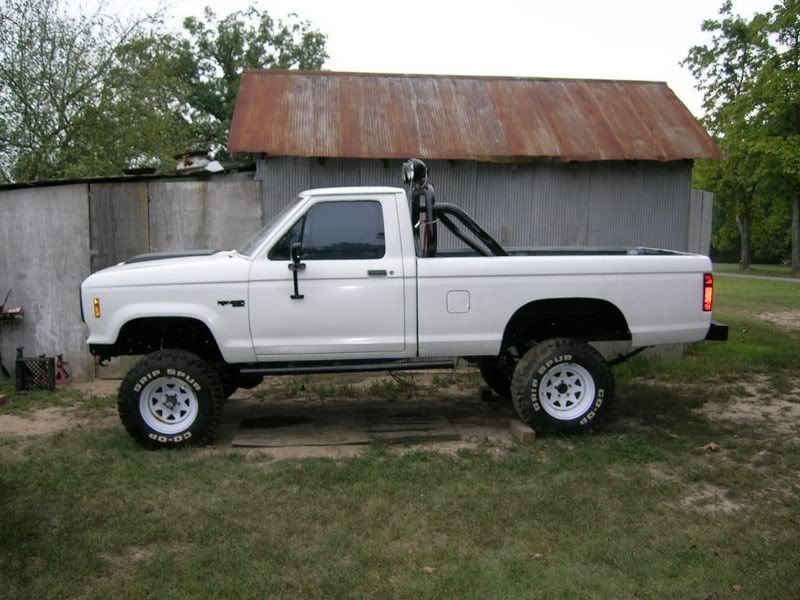

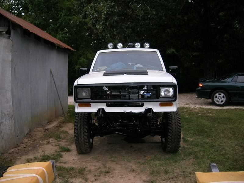

85-4" rough country up front,4" skyjacker arched springs in back(no blocks),3" body lift with 30x10.00 tires on 15x8 wheels.
trimmed approx. 3" off back fenders all the way around,only trimmed front fender right behind bumper 4" (when stock bumper was still on)
this is with v-8 and c-4 auto trans.

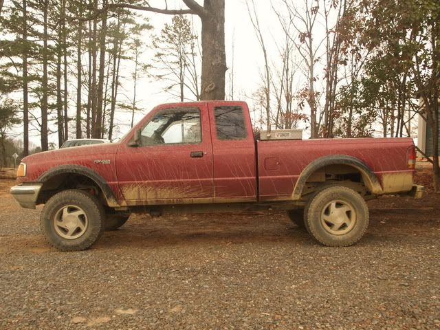

97' with 33" BFG ATs on 15x8"rims.
-Front is 4" brackets F150 coils and 1.75"spacer.
-rear has 2 full length AALs and a 3"block.

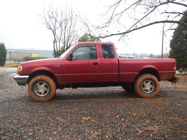

Same lift front, 1 AAL out back with stock block and 31" all terrains

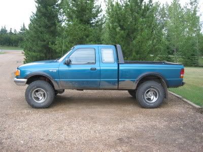

94 2wd 2.3 with 3in BL:
With autofab 4in Lift (sagged springs) Explorer leaf springs and 2in blocks in the back
