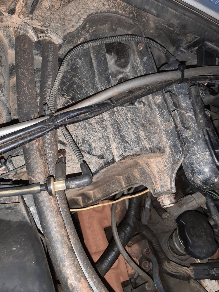

Ok, so this piece that has the three small vac lines, I changed its location from off the motor to my air box and now she's idling better. And the codes changed to 23 (tps to high or throttle adjusted to high) but she's idling between 700 and 800. I still have the 41 code too, but that's it.
