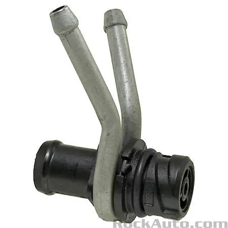

Has anyone found a better way to hold the PCV valve in tight enough to avoid a air leak? I have had a check engine light come on and I checked the PCV vale and I was able to move it into the valve cover a little, I also turned the gas cap a couple clicks. I thought I saw something on here about a way to hold it in better than the little notches. I was also wondering if the coolant line is really necessary? If not, what is the best way to eliminate it?
This is on a 2004 Ranger with a 4.0 SOHC .

Have you tried a new rubber bushing for the PCV to seat into?
I don't think that model has a rubber grommet. It's got an o-ring seal on the PCV valve.

Senornoob, that is the PCV valve I'm dealing with, I just recently replaced the valve cover and then the gasket a second time. I replaced the valve cover because I could get the PCV vale to catch on the slots, so I got the new valve cover off of Amazon and I still have a hard time getting it to catch so it tightens up against the back of the valve cover. I just got the notice that it is due for an emissions check, I think it is May. Right now, I have a tie wrap holding in a little but obviously not enough.
Can you replace it with an old school rubber grommet style? Looks like that design either works perfectly or not at all...

Part of my problem is I got the valve cover from Amazon and I'm pretty sure it is from China. I will get a new PCV and see if I can screw it in better. My motor is a remanufactured motor, when my sons installed it there was already a valve cover on it and I think it was missing the notches, so I got a new one and the PCV didn't screw in correctly on the new one either. I don't remember where, but I got the impression that the PCV was part of the evap system. I think I'm going to loosen the coolant line that goes around it, I assume that would mean bending it? I'll post on here if and when I can do that.
Should be a way to make it fit.
