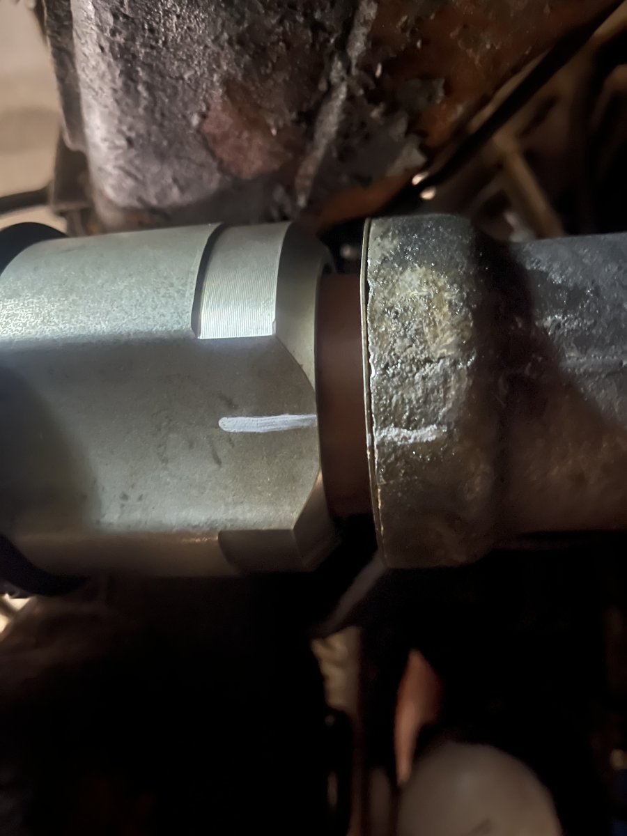

My passenger CV axle will not fully seat. I’ve attached a picture of how much gap there is. The seal is quite exposed.
The splines are lined up correctly, as the axle slides in like butter until it seemingly bottoms out. I also have the C/snap ring gap at the bottom so it “hangs”, as I’ve read it is a good idea. This is the same part number as was in there previously, an autozone duralast gold brand cv axle. Any advice?
Also, an interesting note, once the cv axle is in that position, I have to pry it out. I can’t just pull it out. Which makes me wonder if the machining process for that specific part changed.

I’ve had them stick before because of that retaining clip thing hanging up. I always put a little grease on the splines and that clip before putting it together.
I think I heard somewhere that if it doesn’t want to seat to go at it like a toilet plunger although I don’t know if that’s acceptable to do with the CV ends

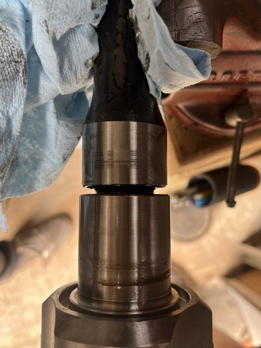

Here is how it looks with the internal pulls out could the internal shaft not be seated fully?

My best guess is that the internal spindle is not fully seated, even though it feels like it is. Maybe getting caught on the snap ring, or maybe its slightly misaligned. Also not sure if it needs to be in neutral or not.
Either way, bashing on it will probably just cause more problems so throwing in the towel.
