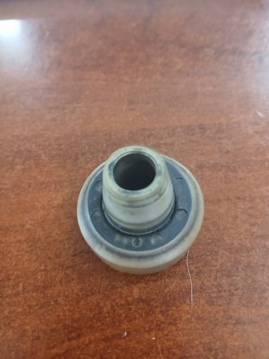

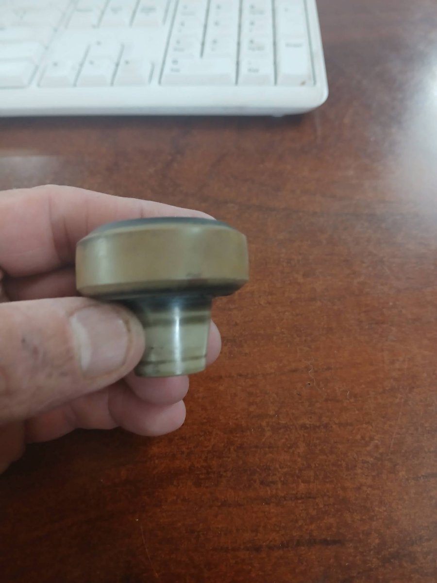

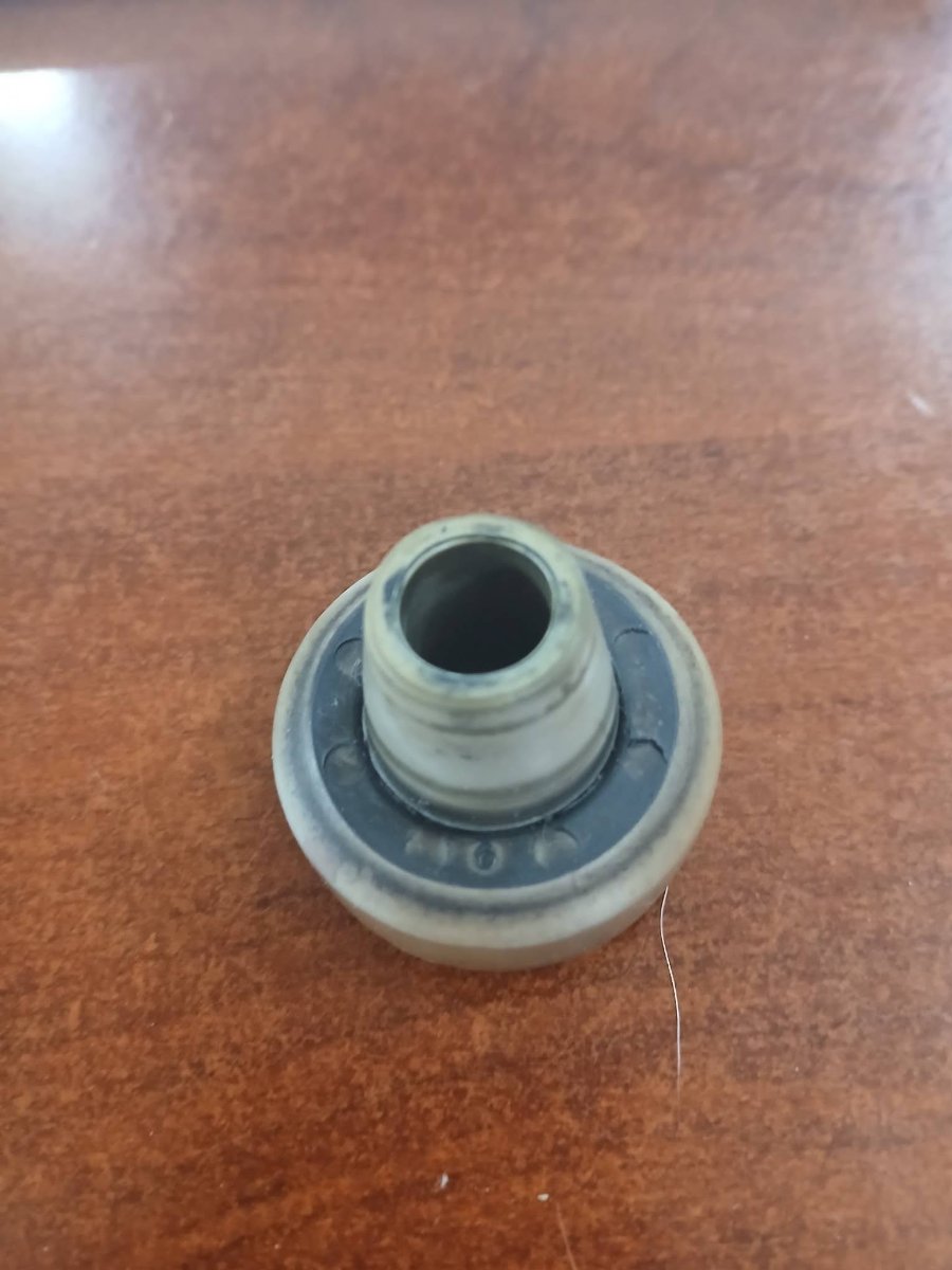

Hello. Thanks for looking at my post.

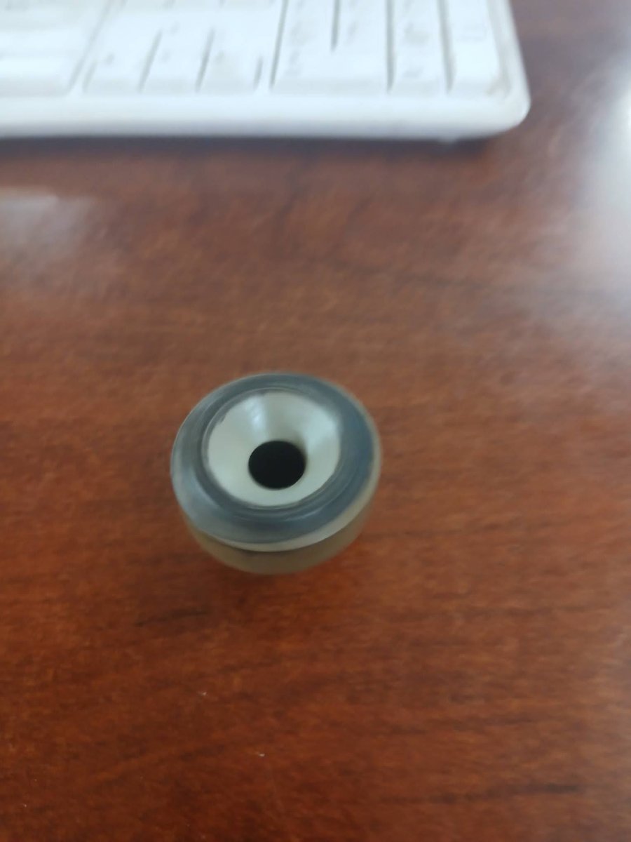

*I found this part in the engine drivers side after cleaning it. Was not there before I started to clean engine so must have fallen off of something. Can anyone tell me what it is or where it goes and if I need to replace it before starting my engine?
Thanks for any help; just being cautious never seen it before and internet said different things like a pvc grommet (which I just replaced other day so not it) and its from a Nissan starter etc...so not sure what the heck it is myself.

That… is surprising unfamiliar to me… I don’t have my 3.0 truck here to look at either. Doesn’t look like anything I remember seeing on a 4.0 truck and I’ve had them stripped down before. The only thing remotely close to that shape that I can think of offhand is one of the bushings for the top stud on a shock…
I don't recognize it at all.
It's an old shock bushing. There is usually 2 of them with 2 metal washer.
Or an old sway bar end link bushing
Definitely sway bar link bushings

Ok, Thanks. I replaced the bushings and shocks last year; do not remember seeing this but it must have sat somewhere in the engine for a year before exposing itself here...lol. Glad it not something I did....
SRD

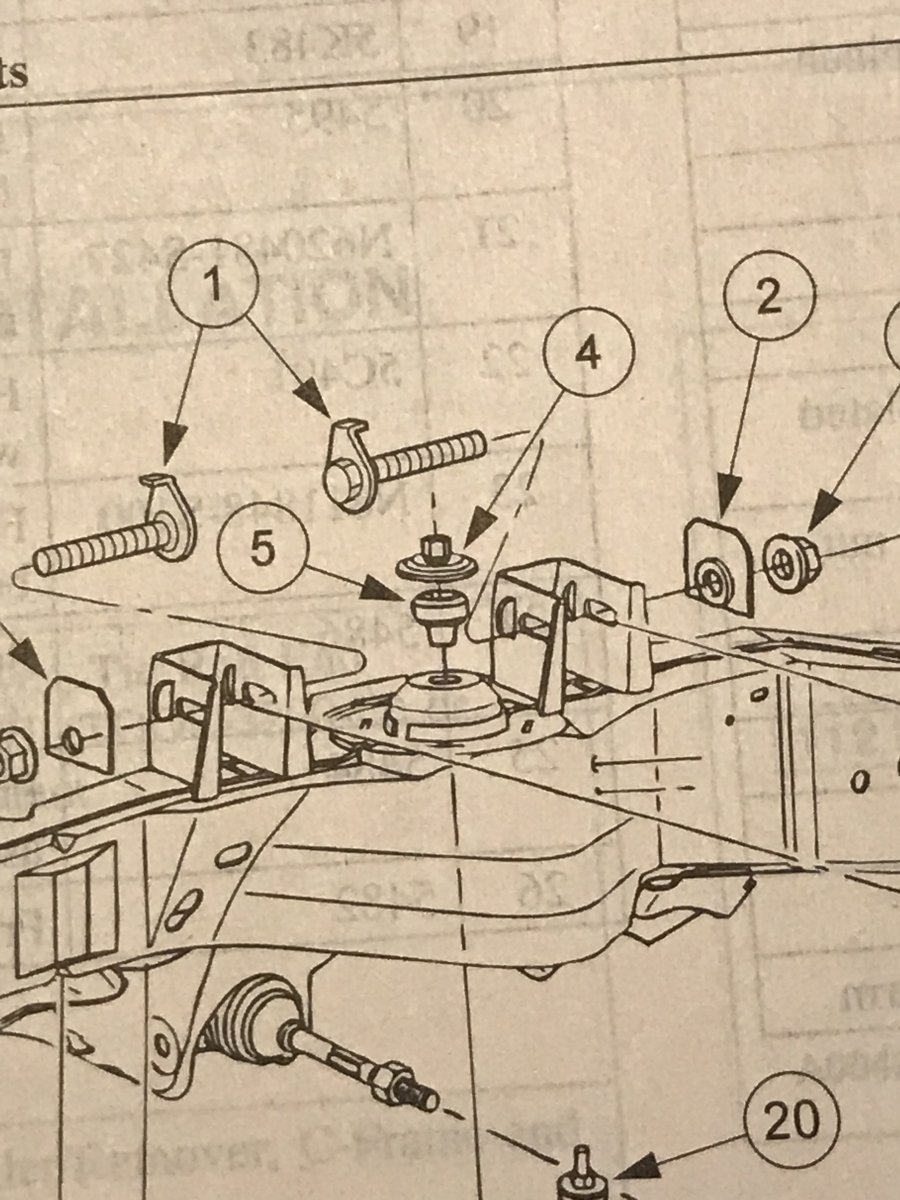

it's the top part of a 2-part front shock absorber bushing set, top of shock.
the tube part goes down thru the steel mount then another bushing goes around that tube part.
the tube part isolates the shock stem from the frame mount, lateral movement.
standard factory issue.
from a 2005 manual:
