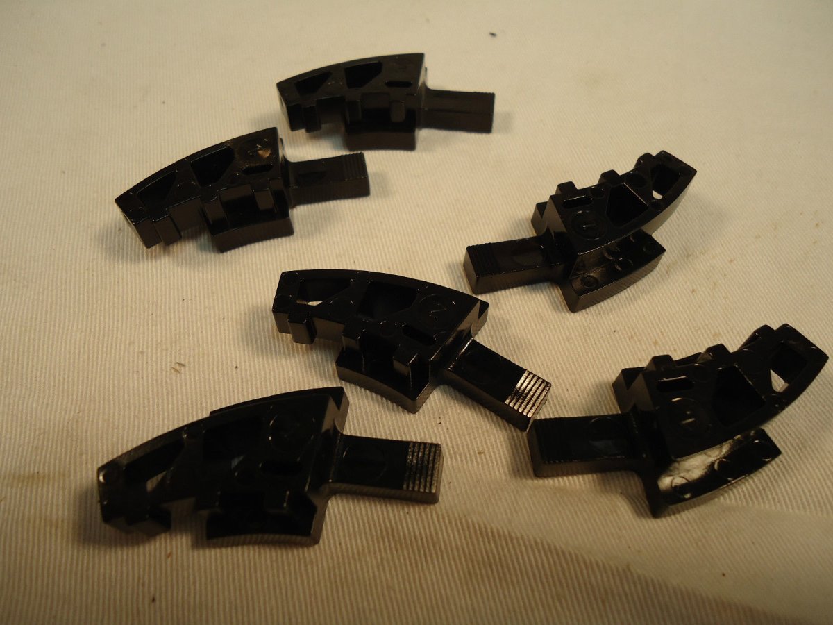

Ford had a service part to correct it, which was a small plastic wedge inserted into the pedal mechanism. I found the part on eBay:
74393
74391
Long story short, I bought and tried this wedge, but it only "kind of half-assed worked". I kept messing with my pedal assembly and found another hole on the mechanism which let me move the pawl spring for more tension, and that's what actually fixed mine.
