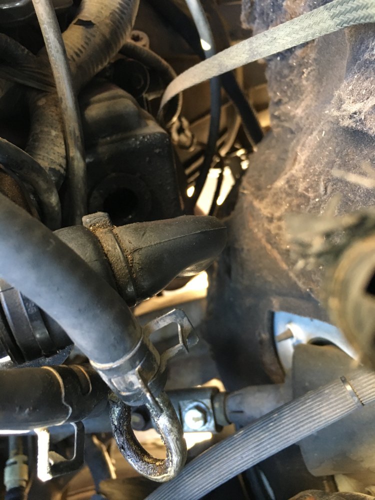

P0174 code and very rough idle
As you can see in photo the hose is pinched quite a bit
Is there reason to believe that replacing it will solve the rough idle
No, just clean it, I don't see where its Kinked, the hose gets smaller but thats the way a new one would be as well
