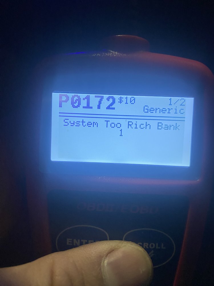

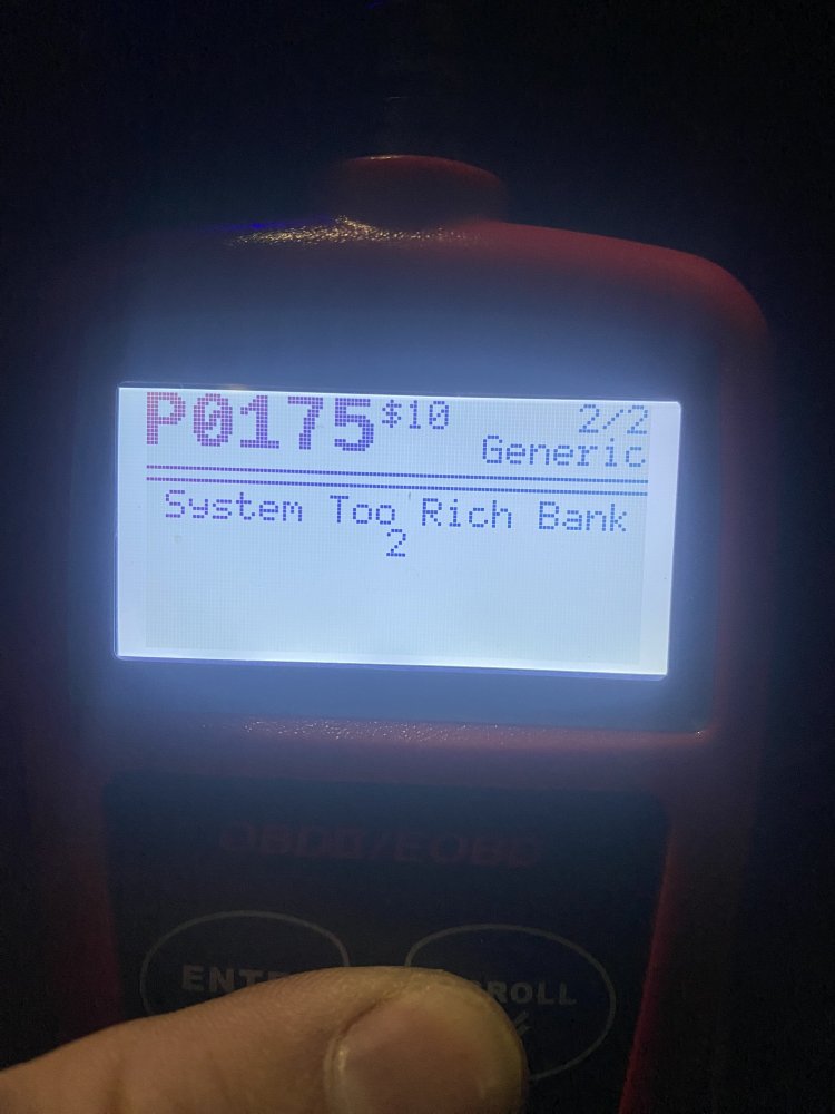

P0172 & p0175 codes rich bank 1 & 2
Truck runs seems like gas is going quicker on the gauge no smoke.

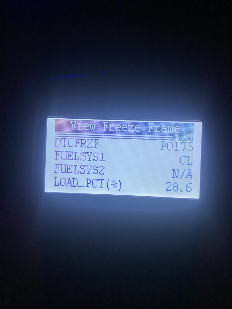

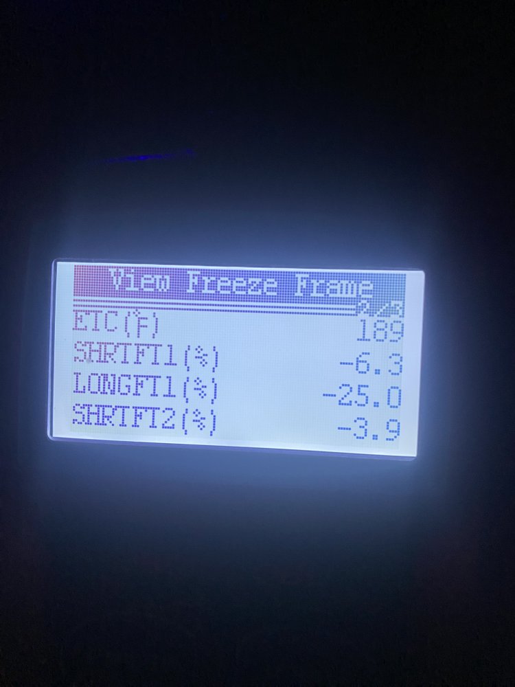

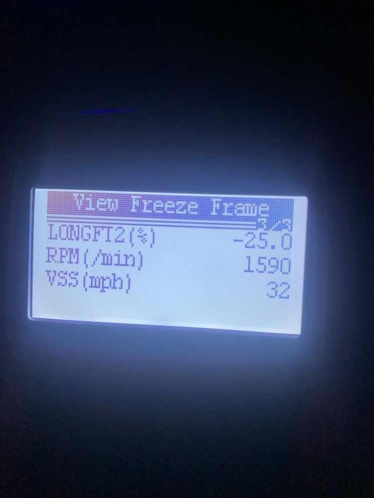

Trying to get some help if possible with these codes hopefully the freeze frame data helps waiting on a live data scanner. In the mail.
In the photos show the freeze data and I did a fuel pressure test results are on paper in the photo maybe someone can point me in the right direction for what parts I should be looking at any advice helps thanks in advance.

TroubleCodes p0172+p0175 are typical when there's a vacuum leak;
check those 5/8"ID rubber elbows in the PCV Hoses (notorious for cracking+leaking)
going from the rightside of the IntakeManifold to the PCVValve on the rear of the LeftValveCover
& from the AirFilter~ThrottleBody AccordianTube to the RightValveCover.
