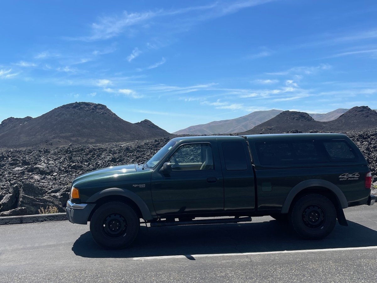

I'm here because last summer I bought a 2002 Ford Ranger XLT 4.0L from a family friend and it only lasted 27 days. I was told by a mechanic that it wouldn't turn, I kind of gave up for a variety of reasons and started driving my old car again. My landlord started pestering me about the truck so I finally got it assessed again and it's true, it was seized. I am considering replacing the engine. I was quoted by a mechanic for $1600 labor and $2800 for a used engine (which seems overpriced, I saw $1800 used engines around) but I am a little nervous about that. After July 4 we will get some pricing on a rebuilt engine.

It died while at a red light, it started rough idling then when I got through the intersection it died. I heard a subtle pfft sound. No knocking or rattles etc.. seemed out of nowhere. The mechanic who assessed it said it's likely the engine lost oil pressure. But they'd need to take apart the engine to be sure. If a rod was thrown or something. I was told by the first mechanic that I need a new starter. This surprised me because my Chevy has had issues or I run out of gas and attempting to start the car multiple times has never killed the starter. The mechanic who might work on it said it turns about 35 degrees then stops. At this point I have two mechanics who say it doesn't turn by hand, that seems seized to me?
