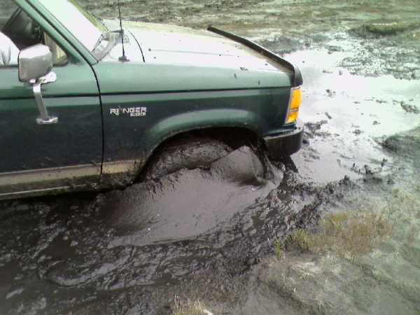

Ooooops, that's soft over there

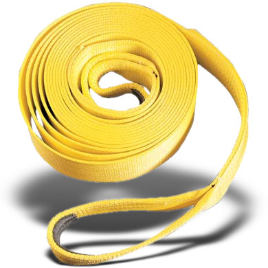

Yank straps = long and have strech
Tree saver = short, minimal strech
Do not include a yank strap in your winch line, unless it is around a tree. If in is long, wrap it around the tree more than once.

Are you talking about tow ROPES? The ones with hooks at the ends? Those shouldn't even be used in any recovery process, they were not designed for that use. A proper strap should have loops at the ends, just as a tree saver.
And there is no problem with using a strap as a tree saver, they are not any less strong than a tree saver, and a slow controlled pull is going to see WAY less stress than it is being used to "yank" someone from a stuck spot.

And yes, a strap will have twice the capacity when in a u shape (around a tree) than in a straight line pull. (This doesn't mean twice the capacity of the strap, check the ratings of any strap before using it, and if anything, overkill is best)

Rope, strap, whatever you want to call it. They come in both forms. I only have a problem with them because the weight rating on most is pretty low.
I know they're not meant for use around trees, but you KNOW somebody has done it.
Tow rope
Recovery strap
Very, very big difference between the two, and the recovery strap can be used around a tree without any problems.
