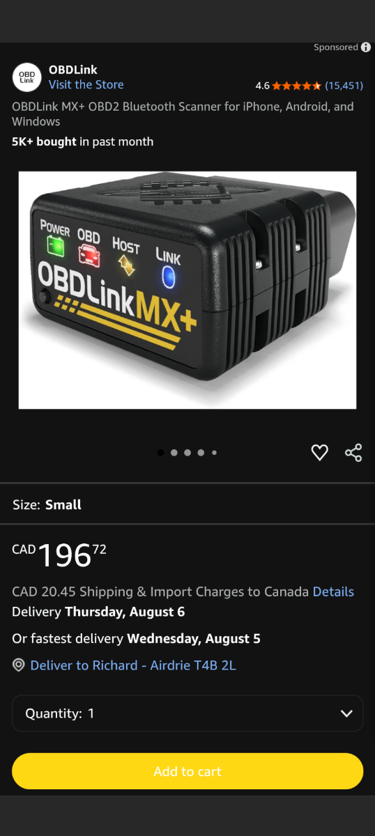

Is this the one? Sometimes Amazon plays tricks on me with links from the states and tries to foist some more expensive crap on me.

The non Bluetooth ones are $30-35 for the good ones.
Just need to be able to connect your laptop to it with the usb cable.
Also, Forescan recommends only using the cable version for making changes. If the wireless connection gets broken during a parameter change you can brick the model.
Wireless models are only recommended for diagnostic purposes. They are good because the laptop can be outside the cabin next to where you are working.
