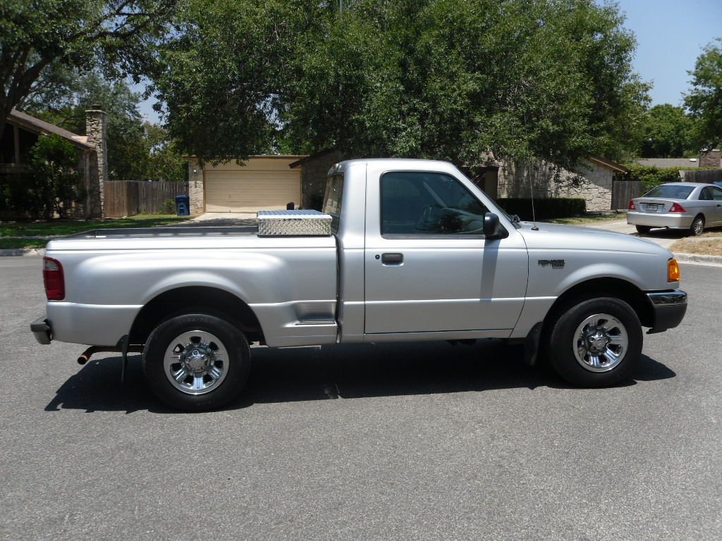

It did it again yesterday but I've just been out there to start it and the oil pressure came straight up.
I just wanted to make sure I wasn't causing any damage to the engine. I've had this pickup for 4 years now. It's served me well and I've grown attached to it.
Thanks for your comments and for sharing your knowledge
Red
2m8YLEuUBLZqz8rn4OAx_4kzh4nHEL7rAyq42hOSSu8=w1024-h768-no
Nice looking and clean Ranger :icon_thumby:
