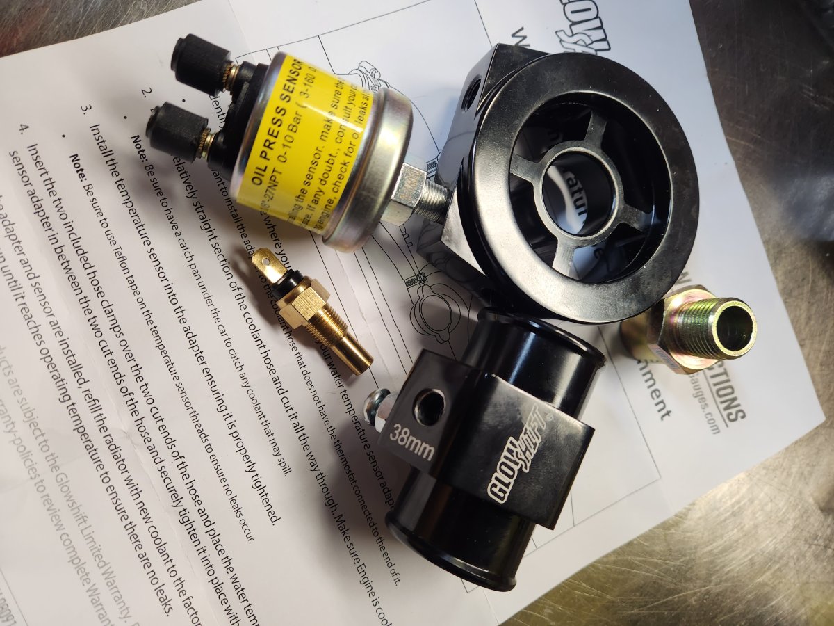

I don't like cutting up the factory harness either. I also wanted to keep the factory low oil pressure warning system as - is from the factory. I chose to use a "sandwich adaptor" at the oil filter to install my oil pressure sending unit... similar to this.

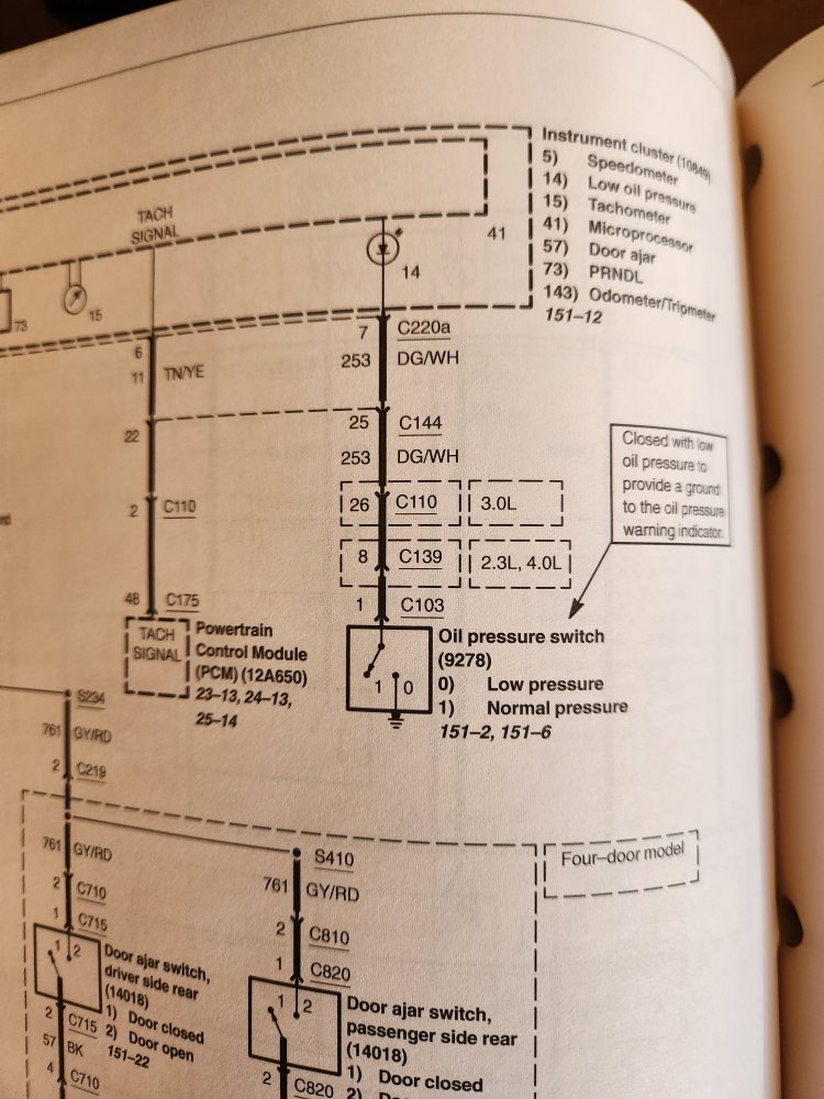

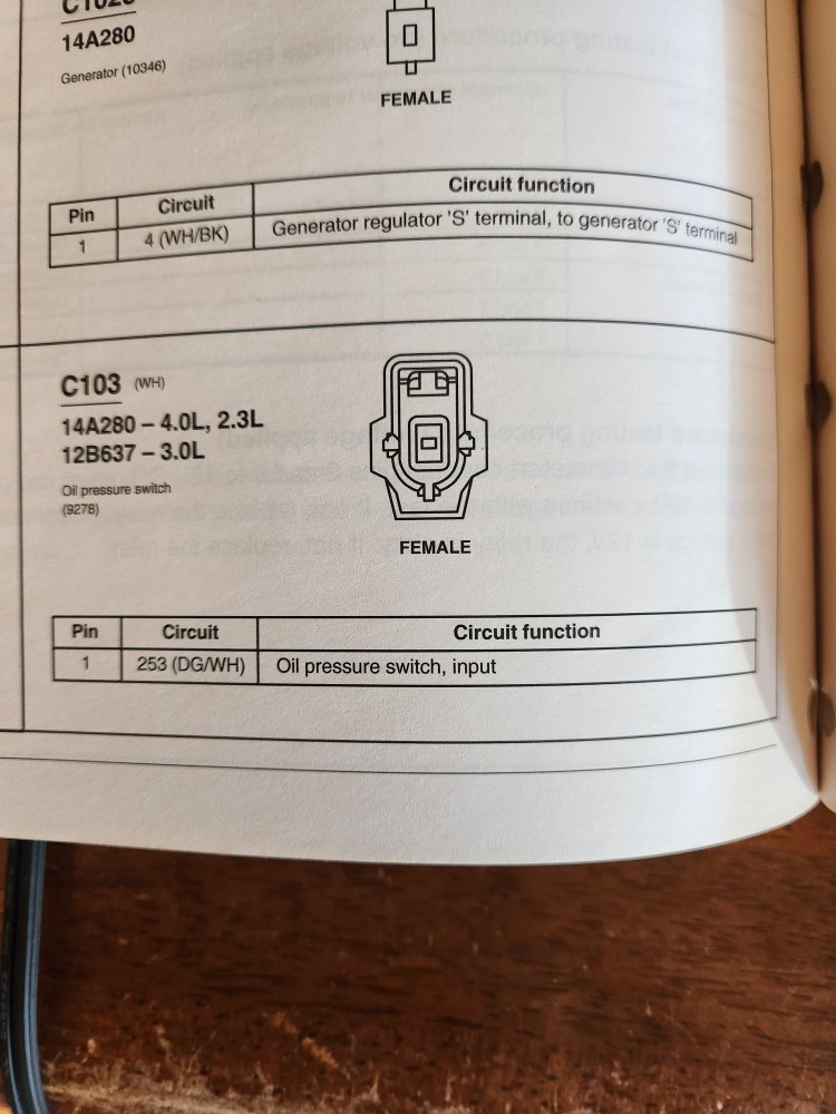

My factory manual does not list a mating connector for the single pin OPS... or a terminal part number. But here is the info that is in there...

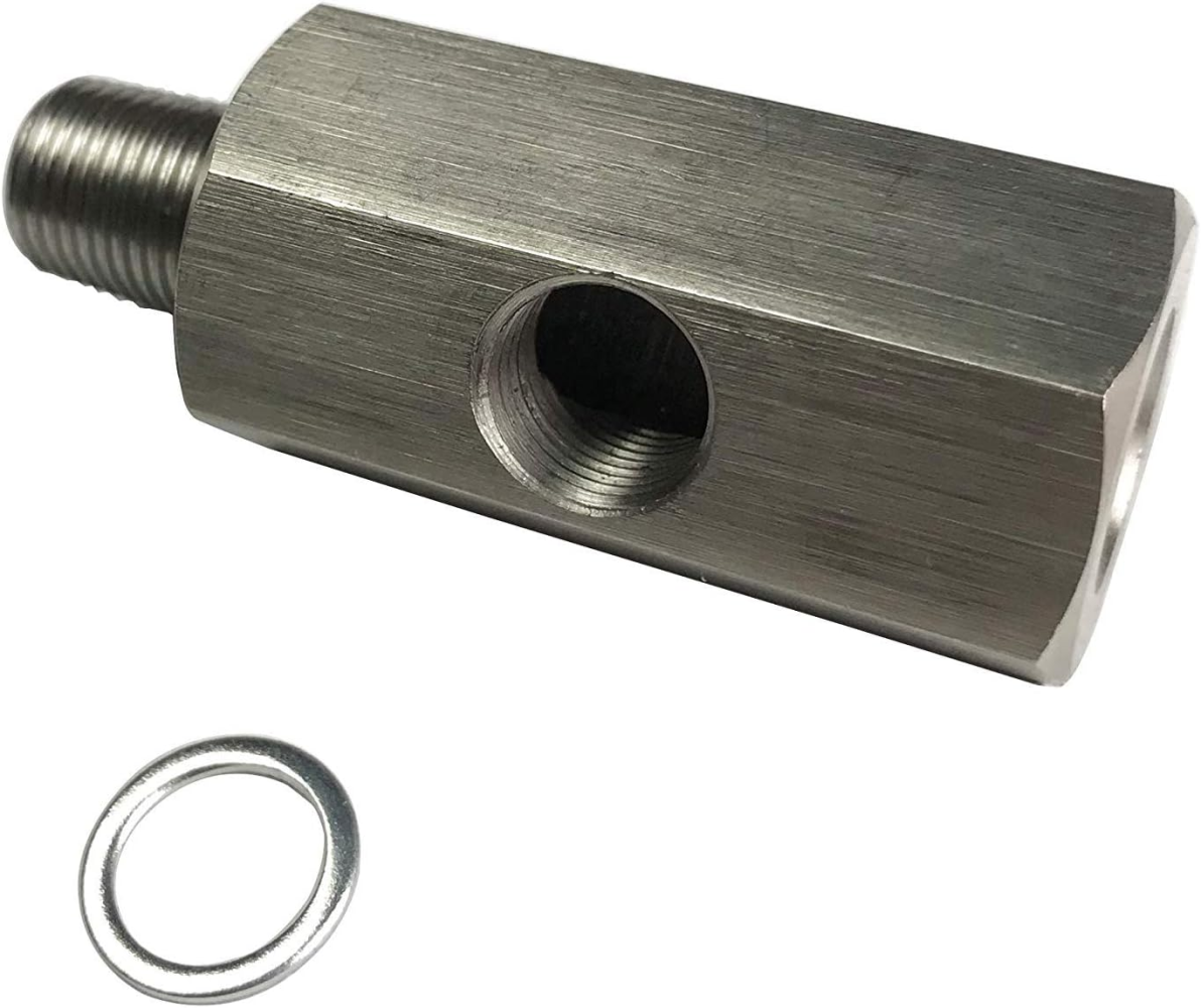

If the contact in the VDO sender is set at too high of a PSI then the idiot light could end up coming on all the time, which is not helpful if the motor doesn't actually have a low oil pressure problem. In this case I'm going to try and run a small adaptor at the OEM location so I can connect both senders and leave the factory one wired to the OEM connector, like this:

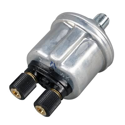

VDO has had senders available with the separate warning light contact in various PSI ratings for years, just not as well known. It uses two connections - one for the gauge and one for the warning light - and uses the threads for the ground just like the OME switch does. Very handy if you can get one with the correct PSI rating and threads, though they are only for VDO gauges. Fortunately, I've always liked the look and function of VDO gauges. :)
The one I've ordered is https://www.summitracing.com/parts/VDO-360009 - it has a 1/8-27 NPT thread, so is easy to get a bushing to adapt to the slightly larger factory 1/4-18 NPT thread on the 4.0L motor, and the warning light triggers below 7psi, which aligned with what I could find online about the factory switch, and seemed like a plausible PSI for the "oh crap, shut it down NOW" dash light to come on. If you look closely at the sender it has a G stamped into it for the gauge wiring connection and a WK for the warning light connection.
You have to be careful as not all two-wire-connection VDO senders have a warning light contact, some of them have a gauge connection and a gauge ground and don't use the threads for the ground. The more common ones only have one connection for the gauge.
