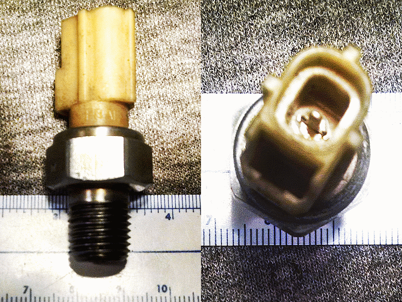

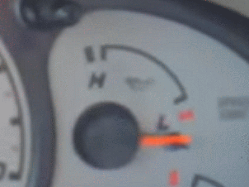

OilPressureSwitch that drives OilPressure indicator (fake Gauge, just an Off~On Needle) in the InstrumentCluster,
is notorious for delay &\or failure; that may be the issue. OilPump could also be failing?

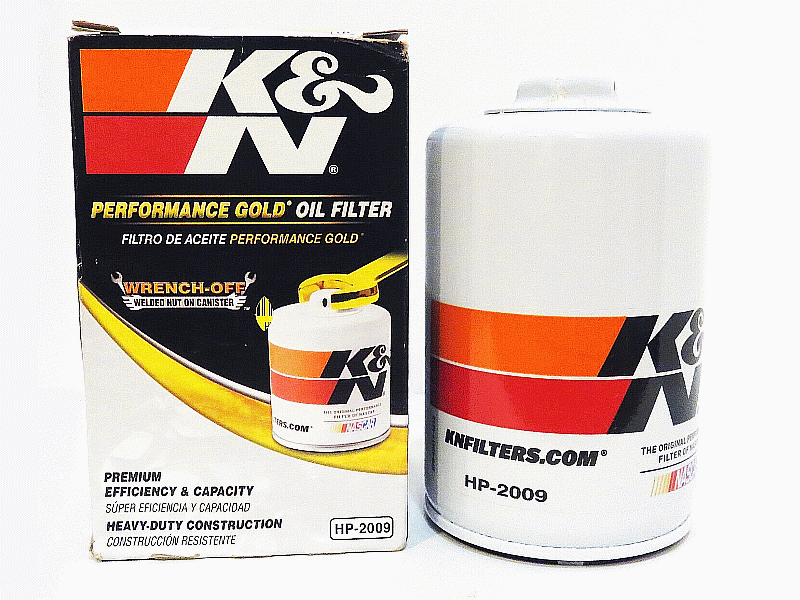

Prefer K&N#HP series OilFilters; higher flow & lower pressure drop ratings than stock filters, plus 1"HexHead makes them EasyOff.
