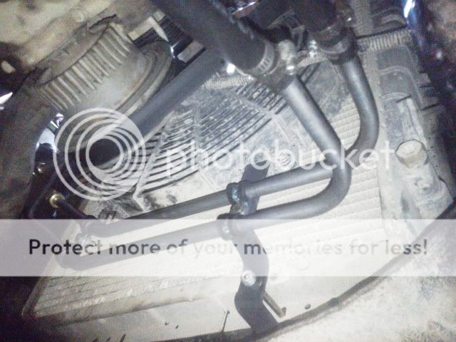

I just put in a sandwich plate at the filter and ran 1/2" lines up to the factory auto trans cooler ports on my radiator. It allows the engine to come up to temp faster and more uniformly.
I the hose clamps on the tube were temporary. I used 1/2 compression fitting to 1/2" barb to join the hose to the tube.

I just put in a sandwich plate at the filter and ran 1/2" lines up to the factory auto trans cooler ports on my radiator. It allows the engine to come up to temp faster and more uniformly..

Not really following some of this logic. The oil getting cooled is going to help the engine to heat up faster? I would think that with both the oil and water circulating thru the systems would distribute the heat rather effectively. Without a cooler does the water come up to operating temp before the oil or the other way around?

In my experience, water first, so after intial startup the coolant warms the oil.
Most auto trans coolers utilize both the oil to water cooler and an oil to air cooler.
This way ir heats up faster, but runs cooler.

I also am running a 180 t stat and a weak electric fan that needs to be upgraded.
