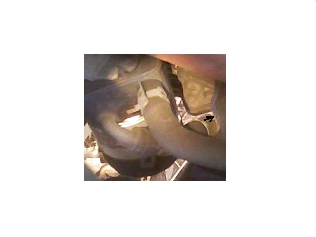

Ok, well here is a picture with my cell phone. Not the best but hope someone can help.To begin, this is an oil cooler correct? The line that the arrow is pointing to is the one with the small leak. You see how there is a small portion from the "cooler" to the arrow that is rubber hose, then the metal thingy at the arrow and beyond that where you cant see is a metal tube running to the engine or radiator(cant remeber which). My leak is coming from the metal thingy the arrow is at...now, how do i fix this? Can i cut this section out and replace with a lentght of rubber hose? I hope this pic can get an answer-:icon_thumby:

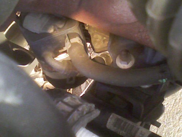

this is the original picture before i zoomed in on the oil filter and put an arrow on my problem...
what side of the vehicle is this on? I need orientation to figure this out.
This would the right(passenger) side...the picture was taken on the right side looking down, it was the only way i could get a decent pic with my phone. let me know what else you need to help me fix this.
If understand correctly it is leaking down the hose off what i think is a crimp fitting on the hose. how badly does it leak? is it affecting your coolant level?
You're right. That crimp fitting is dripping. The level is kind of low, it doesnt leak bad, not on the drive way or nothing. But, i dont want it to become a big issue one day driving down the road. I cant find a repalce ment.. Im trying to find out, if i removed that section, could i just replace with all rubber? Does the crimped part serve any special purpose?
well the cooling system only has about 15-16 PSI so i would say if you do it correctly there should be no problems.
