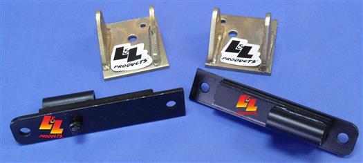

Also, L&L makes an engine mount kit for $175. Looks like it is of pretty good quality. I would consider ketting this...

Looking at it more, though, it looks like it uses V6 mounts as a base and then the adapter goes on top... lurrdddd things can get tricky.
Don't waste your money on that. Use your factory 4.0 rubber mount and just fab a plate to bolt to the block. If your not up to it, I can fab you a pair. This also allows you to get over the counter parts if you need a motor mount, unlike the custom mounts everybody else has...

Two things about that... I got a 4 banger, not a 4 liter. But I just looked it up on Rock Auto, $13 each. So no prob there. Also, do the custom ones that you make sit lower than ones if I were to buy one from say AA?
And two, how much do you charge? :icon_thumby:
The way I make em is about as low as it will sit. The block bosses that the mounts bolt to sits 1/4" higher than the top of the rubber 4.0 mounts on the passenger side, the driver side sits about 1.5" above mount (to level the motor). I can fab the plates for you for about $25 a pair (basically covers materials ) plus shipping...
