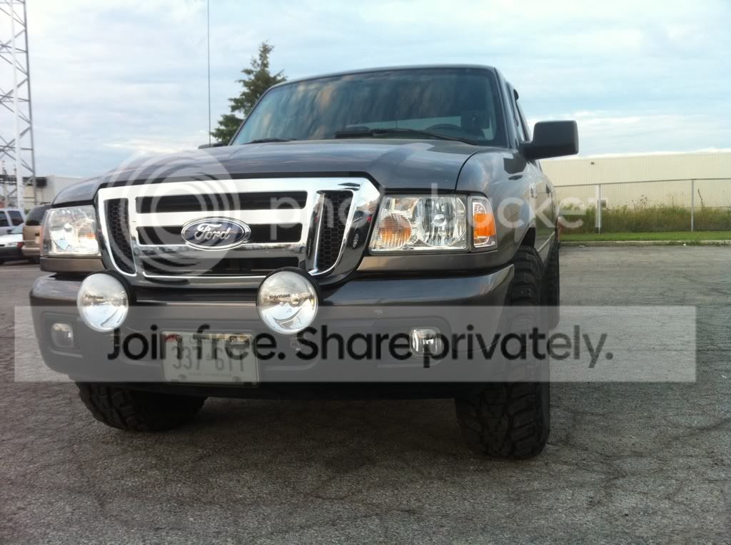

I'd say you should be ok with that set up. here's what 265/75r16 on stock rims looks like with NO lift and i have no issues with rubbing so with a lift i'd say your fine. (mine's an '04 ) to give you an idea
