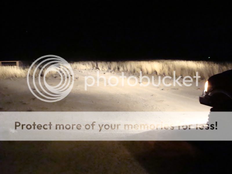

Theres mine not sure of the brand, there bright as hell tho. Im about to start on a roof rack prerunner style light bar with 4 Kc's

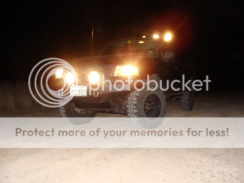

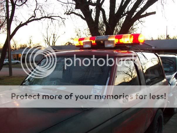

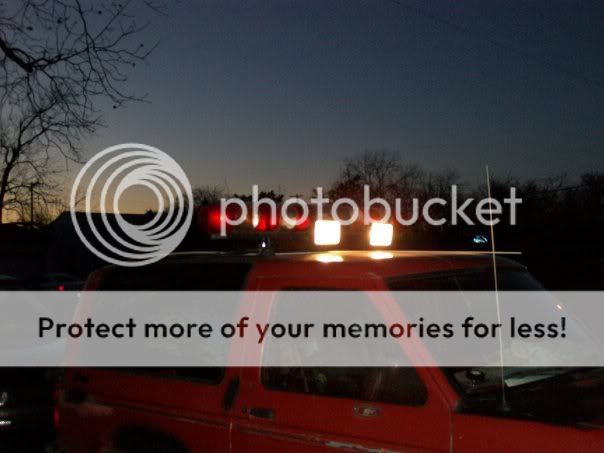

I knew I had some old pics that showed my lights, anyways 2-7" hella knockoffs up front and 4-6" daylighters up top
