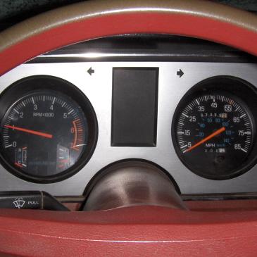

Speedo still works but odometer quit. Easy fix? What other year model dashed are compatable with the 1886? Would like to haveo ne wuth a tachometer. Interchanable?
Shran did a tech article writeup on how to change the cluster to add tach and the general indication is that 83-86 (direct interchange??) could be made to work with up to an '88.

On a '96 you can pull a cluster with tach from a '95-00 or thereabouts Ranger or Explorer with tach and swap the whole thing in.
Apparently the odometer gears are known for stripping on these things at times, I haven't ran into that myself, I think it's a '95 up thing...

Their signature shows '96 so that's what I was going off of... on the older versions with full on cables ('83-94) they're usually all or nothing, on the next versions the odometers will apparently stop working, I've heard there's a replacement gear available but swapping to a tach cluster is nicer anyway... heck you can do that on your '90 too, I did it to mine, you would just need a '89-early '92 cluster... I don't remember what color the PCB is supposed to be but I looked a couple months ago...

My understanding on the newer clusters like 96 is that usually if the plastic gear goes, you have no odometer or speedometer. I did have to replace one on a friend’s 96 Explorer. You have to yank the cluster and tear it all apart for a tiny plastic worm gear on a small electric motor. Annoying, but not really difficult, I did it in a couple hours and spent most of that time talking and drinking beer. Little plastic gear was like $10 bucks online. I bought two extras to put in my parts inventory, lol
